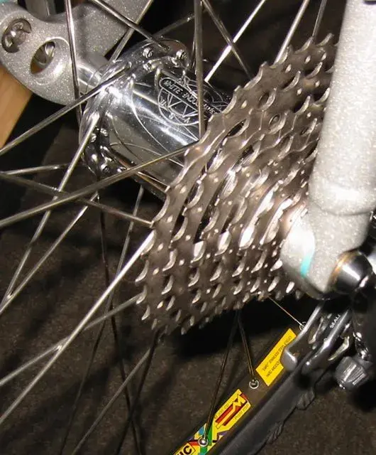

I need to change out the bearings in this rear hub. Would anybody here have any information to help me? Thank you. Cheers.

super easy. for the non drive side you just need to loosen the grub screws on the axel spacers then they pull off revealing the bearings. on the drive side you remove the cassette and do the same. i think you have to remove the free hub so watch out for the pawls and springs(should be three or four of each).
Hey, thanks for the quick reply! This is the only cassette-type hub I own. I was worried about the drive side. Guess I'll just take it apart and try to see how things go as I unravel it. Much appreciated. Love this place!! :D

You can still get the service info for this hub from the White website :wink:
I found it just last year when i was servicing the same rear hub.
