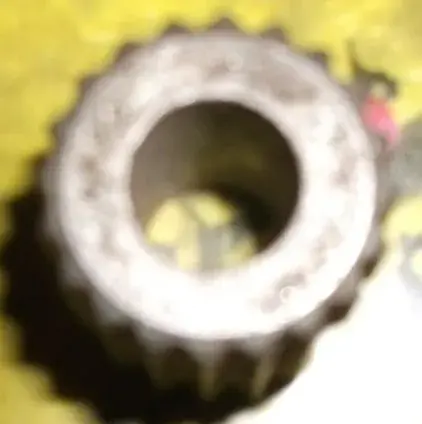

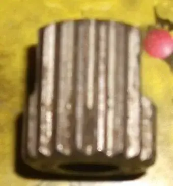

How would I remove this freewheel?
I see it has two holes within - does a tools two prongs slot in here ?
Any help appreciated
You need to take the outer axle nuts off and there is a serrated hole inside the freewheel, TBH these always were a bit of a PITA BITD :wink: :D
As for the tool I am pretty sure it is this one

Re: Re:
Thank you!
Appreciate that
I will look for one to buy online
I am 99.9% sure that is NOT the case on this one, I would remove the outer nut first it should then become clearer if the serrated hole has squared off edges it may well be a Shimano tool, if they are triangular peaked then it is the Maillard tool :wink:
Couple of minutes will save a lot of messing about later :wink:
