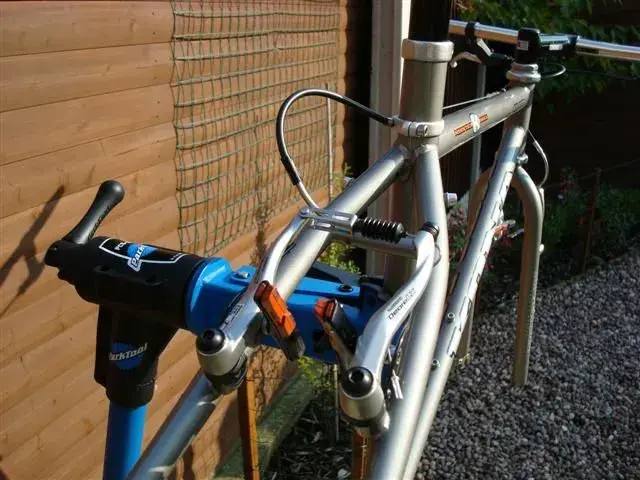

Or do the job properly...
Sorry for the horrendous pictures :oops:
