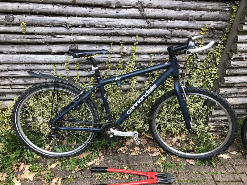

I picked this bike up yesterday - it has no model number on it, and very little in the way of any writing. The spec fairly closely matches the 1998 F700 (Mavic 221 rims, Deore LX rear mech, CODA chainset), but as you can see, it is an 'F' frame, but has no suspension.
I can't find any catalogue scan, where this setup is shown. There are 'M' series with P-Bone forks, or 'F's with Headshok.
Does anyone know? Thanks

There should be a serial number on the bottom bracket shell, if you go to www.Vintagecannondale.com you should be able to find the tear from the first letter of the serial number.
It kind of looks like it may have had a Headshock at one point?
Okay, so it is from June 1997, but I still can't find any bikes with Headshok frame and a factory fitted rigid fork? The colour is a very dark petrol green/blue.

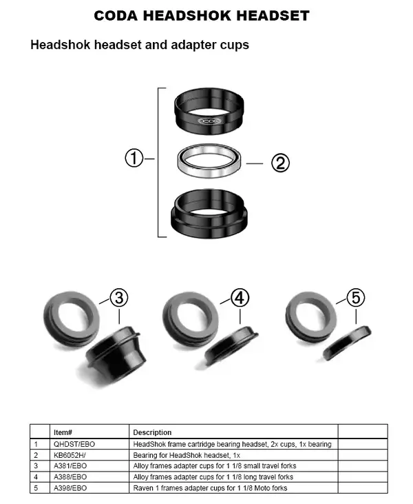

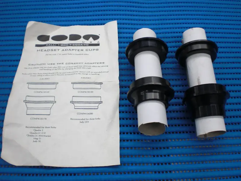

It is an F series frame with Coda A381/EBO adapter cups, Diatech headset and P-Bone rigid fork.

Thanks - that's exactly what it is. What I don't understand is why it looks like it came from the factory like that? The forks are the same colour as the frame, which I doubt could be done outside Cannondale's paint shop, and it hasn't had a respray? Did Cannondale sell them like this, in any country/region?

Its a Caad 2 F series, it looks like a mid season offering from around. either 98.5, or 1999.5, hence the reason it doesn't have a model designation, but i think f400 mid year, and offered rigid with a factory P-Bone with reducing cups as mentioned above. Offering a mid season bike, in a different colour way, with different options, topped up dealers stock, as they had to pre order in Europe so far ahead of actual delivery. The rigid fork option helps compete in the marketplace and reduces the price point on the shop floor when compared and competing with its cheaper far east counterparts, given the frame is handmade in the USA, assembled there, then shipped to Europe and the end dealer. A far more expensive process than far east options.
It certainly doubtful you will find an exact image in a yearly catalogue to match, as these were pre-printed before the midseason options became available. You might see a flyer for it though if anybody thought to keep one, Or a Mag image or review maybe.
I hope that helps.
