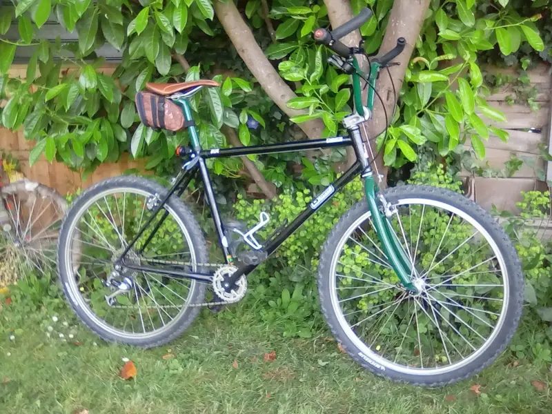

Meantime, here's my Mirage, 10k miles and still going. Front forks are Spinner Biplanes, the stock ones were ok but heavy.

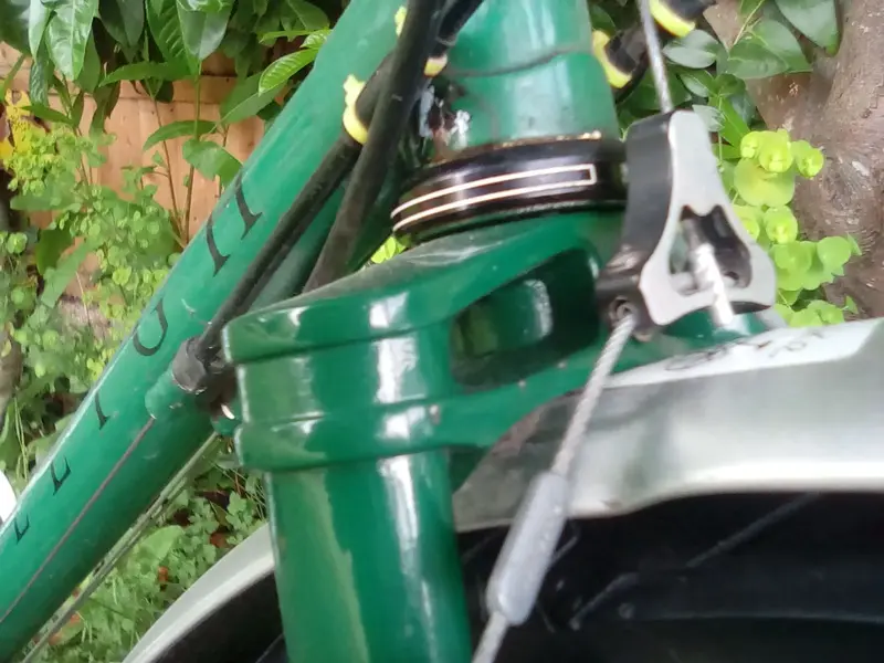

And a close-up of the Biplanes, probably worth more than the rest of the bike put together. Bought them for the 25th birthday of the bike ("Desperate Dan"), not me. That ship sailed a while ago.

So, yours is a later one, in groovy purple I assume. Mine was white from new, I got the green paint going many years ago. If you're interested in the history of Raleigh, you could try finding the book "Framing Production". No use for lists of individual models, etc., but a full and interesting history of the company. My other Raleighs are an '89 Montage, an unusual '90 Moonrun with different geometry and oversized headtube, and a '91 Summit. Photo of Moonrun below.
