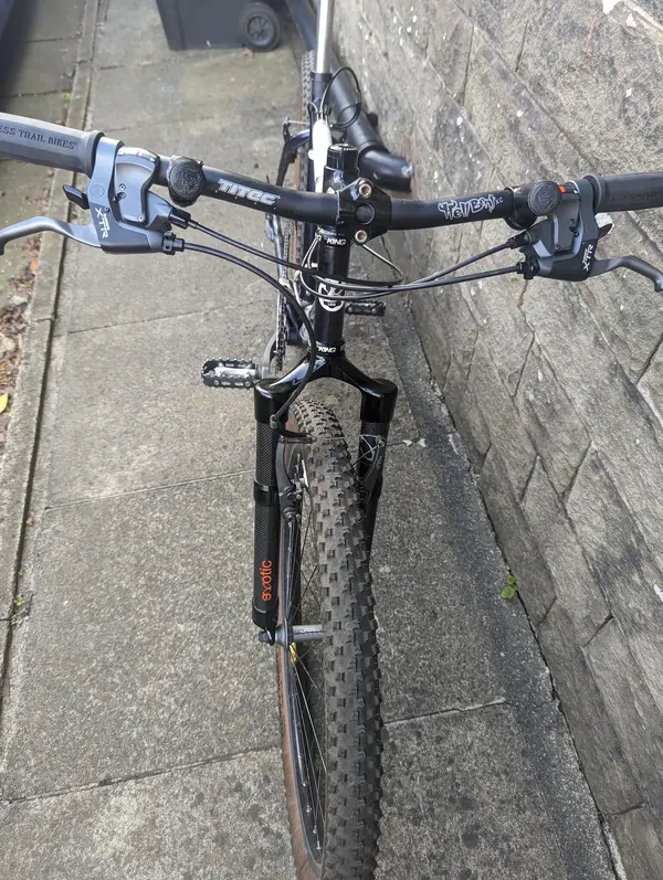

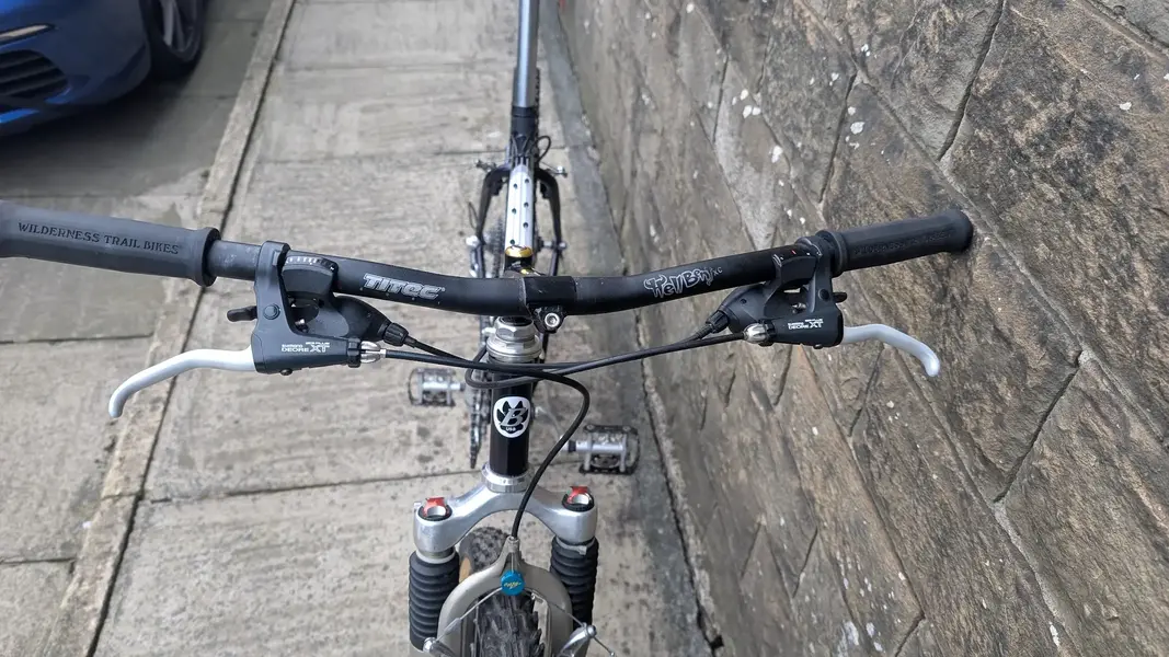

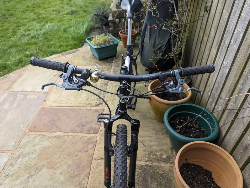

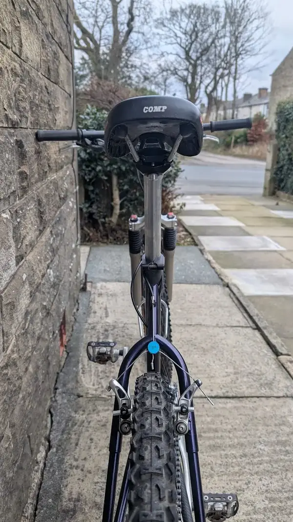

It's more extra hand positions and getting a bit of aero tuck in longer stretches

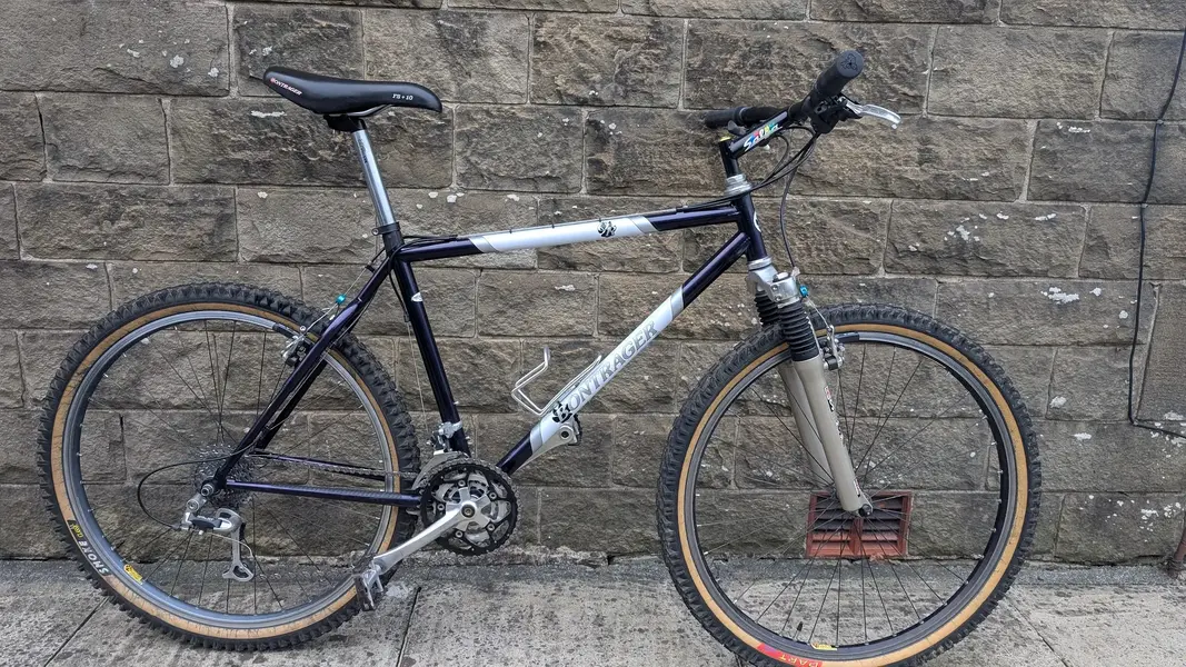

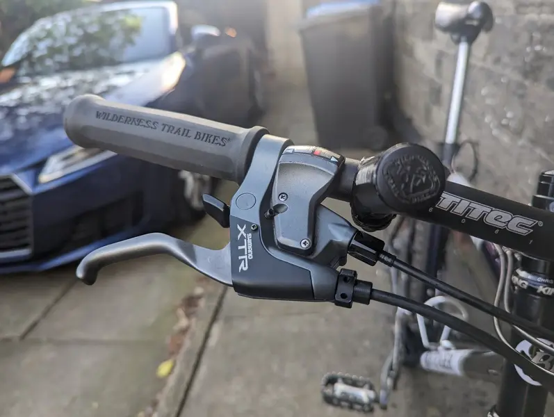

A few final changes to this. I picked up a (relatively cheap) xtr chainset which arrived today. So it's now sporting a full xtr groupset, including hubs.

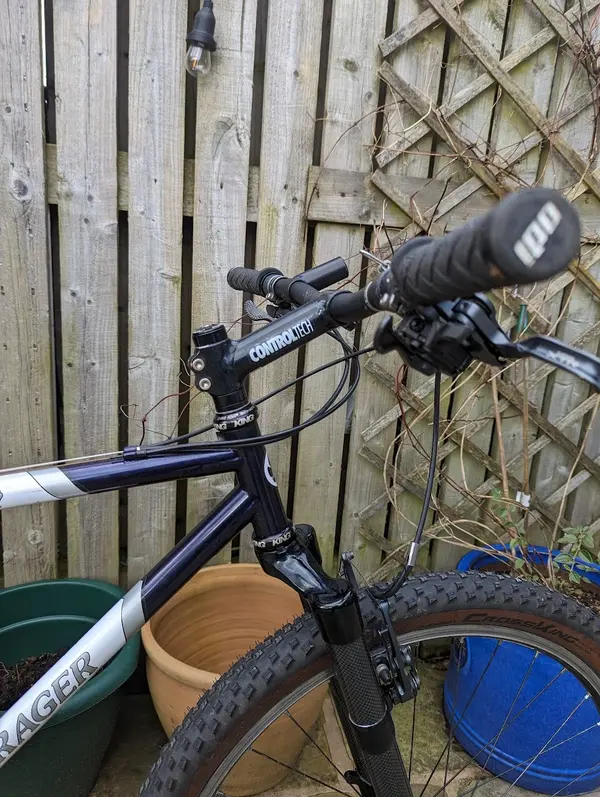

I'm not sure what else I could do it this to, bar finding 1" ahead stem, but I rather like the control tech one. I've got an ahead steerer for the Judy's so they will just drop in whenever I want front suspension.
Luckily a 109.5mm 105 octalink v1 bottom bracket is a good fit for a bontrager, so the cranks fit with the cheap BB I picked up off eBay, and I should be able to get some spares in as well.

However, my favourite touch is the matching wtb logos on the grips and bar ends.
Very slick, love it! How do you like octalink?
If i'd known how difficult it is to get octalink v1 bottom brackets and that the xtr ones are a weird length compared to what's still available I don't think I'd have bothered. Probably would have tried down some middleburn square taper cranks instead.
But it does look cool and finish the bike off nicely.
I now need another bonty frame on which I can use all the nice m737 stuff I've got. Shouldn't have sold the racelite. :)

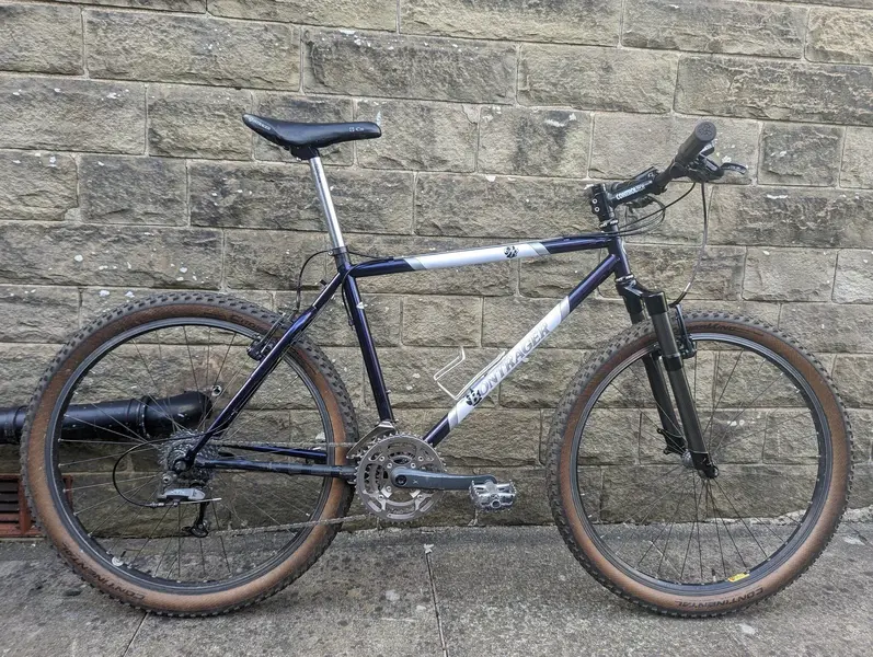

Gave up on the M950 groupset and have gone back to a restomod build with M9000 and M8000. Also found a 1" controltech stem and an older mustang rear.
So now we've got M950 brakes & hubs, M900 shifters and deraileurs and an M8000 double crank.
Which is just about perfect for what I use it for.
