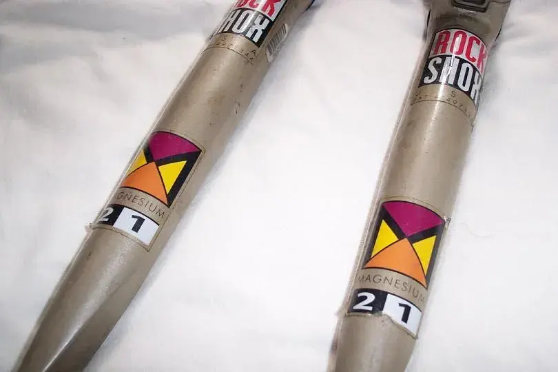

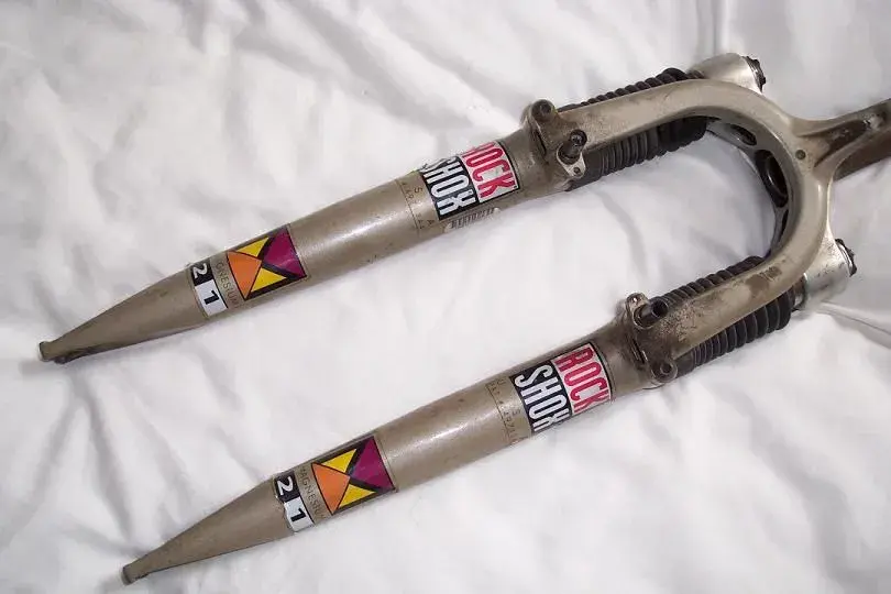

what Rock Shox are these?
therollex
They have the magnesium sticker, I don't think air operated ones? thanks in advance

20s or 21s, see the little tiny screw at the centre of the top dial, undo that, air goes in there via a needle valve pump.
1993 MAG21 The first MAG21 they did. There are service manuals on this site in the Archive (and if you are interested and search there is a comparison between the MAG20 and MAG21 I think in one of 'pickles' threads, I was going to put something up in FAQ at some point.)
Its also the same MAG21 that came with my GT when it was new.
MAG20s had a very squared off brace which pitted badly any sign of council road salt...

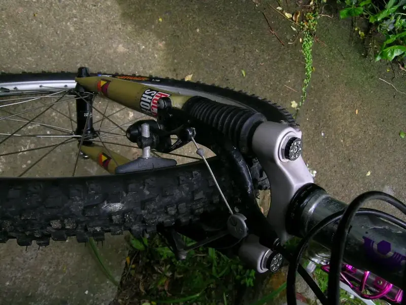

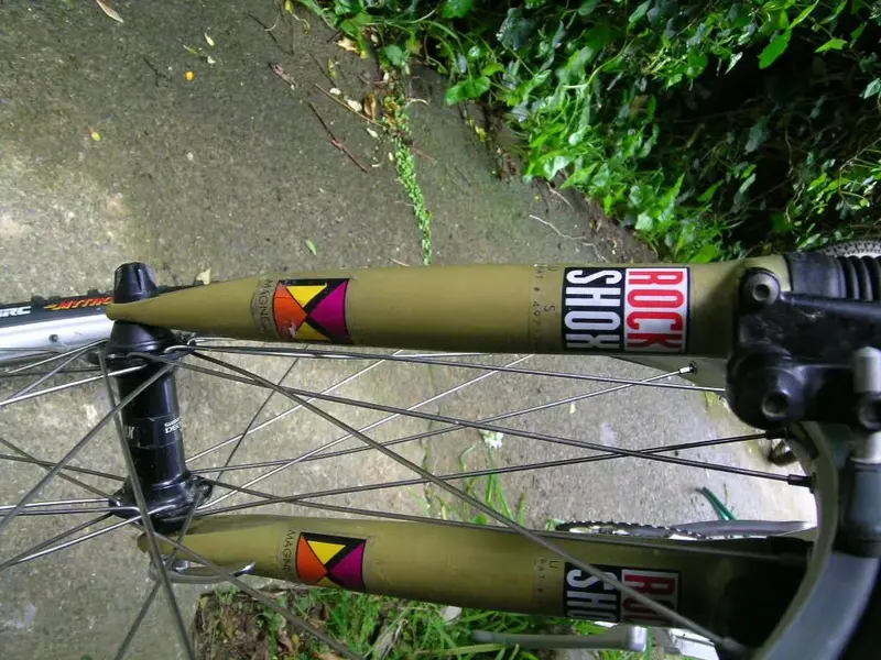

Here's a couple of pics of my Rock Shox 1998 Judy SL!!! :?
