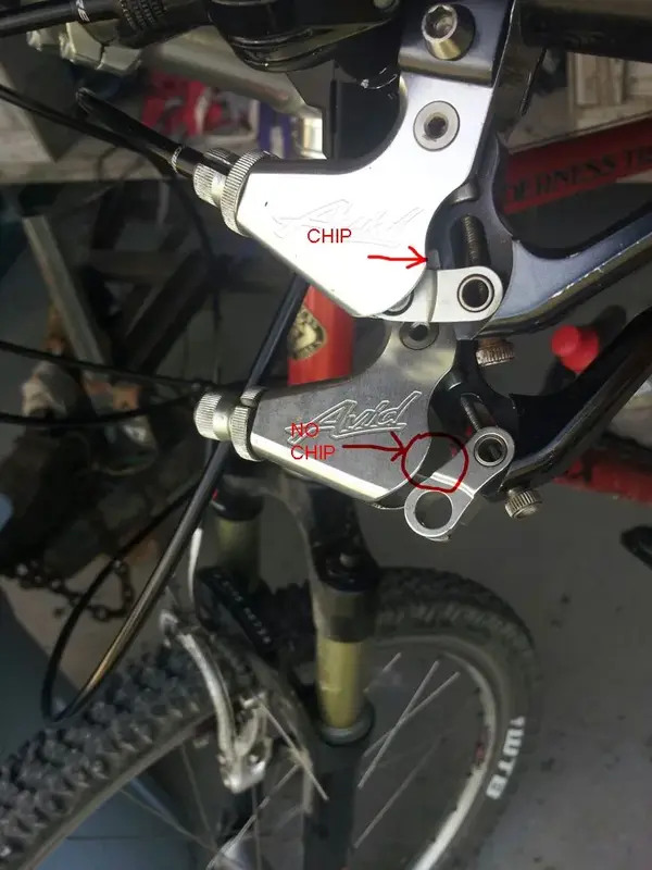

Well this is timely. I finally figured out the difference between the chipped and non-chipped levers, just last week - ironically to pair an an arch supreme front brake with a pair of cantis in back. I'd heard about the different versions but, until I held both in my hand and really looked at them side by side, didn't understand what it was. It's not possible to tell the difference from your photos, so hopefully this picture will help. And hopefully you actually have the right ones.
The V-chipped ones have an extra piece of material on the adjustable cable yoke that prevents it from pivoting. (kind of shown in the catalog, but not with the other version for benefit of comparison) In the non-chipped ones, it is allowed to swing freely. So it's not just a matter of having the leverage adjustment screw, which both versions have!

The V-chip is not removable. It is machined into the cable carrier / yoke thingy. I wish I'd taken better pictures before I assembled the bike. It was completely hazy to me until this project, and it's a really subtle difference.
With the chip, you can use them for either canti or V, by adjusting the cable-throw position via the speed dial. They feel remarkable balanced when mixed, but not perfect. Without the chip, adjusting the speed dial makes some subtle difference in leverage ratio, but not enough to compensate for the longer cable-pull requirements of linear brakes. So the maximum setting will feel "better" than the minimum (standard cantilever) setting, but still be somewhat "spongy."
