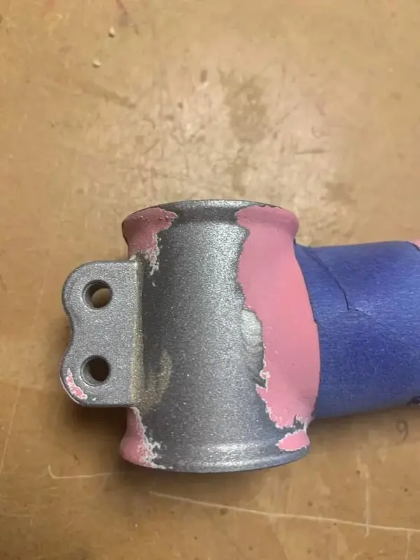

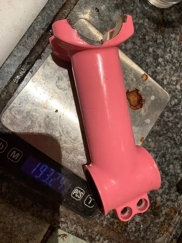

IMG_0644.jpeg IMG_0645.jpeg IMG_0646.jpeg IMG_0643.jpeg Also, I think I succeeded with a partial repair. I practiced on the stem that was to receive a full repaint. It’s pretty much impossible to properly strip with sand paper. It’s very important to strip all the rust and bad primer off the target metal, then clean, then primer. Mistake people make is to concentrate on the final appearance but the most important part is before the primer is put down.
Find a place that can media blast, or build a cabinet yourself.
In my case root problem was an innovative zero voc water based paint process from ppg that would fail 5% of the time.
Added more pix so you can see what grey metal looks like. Again once stripped you wash with thinner and then again with isopropyl alchohol. The epoxy primer takes 3 weeks to fully cure.
