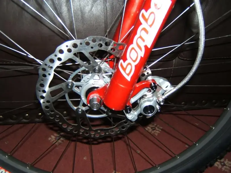

I would suggest Hopes new tech X2 :D
They look very nice too
Amongst an old set of bombers a modern wavy rotor and a 5 bolt hope spider that is :lol: :lol: :lol:
