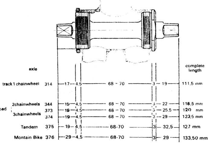

I've worked it out now.
I found this:
main.php
It's the same Crank (already fitted to 44T single ring) (Will replace that with 49T)
And here it has the BB spindle length size listed for "Plateu Simple" which I think a Single ring? = 111.5
Correct me if I'm wrong.
The length seems right as 112 is a sort of guide length, do you have a TA BB of that length?
Shaun

I think you may need to source a correct TA BB as I think the taper is quite individual and not the same as Shimano or Campag etc. TA made a couple of axle lengths (or possibly 3?) for single, double and/or triple chainsets. Possibly a Stronglight BB may be suitable but someone more qualified than me needs to confirm this!

I'm pretty sure TA cranks use square taper ISO - I haven't read or heard anything to the contrary
TA were normal ISO taper but at the narrower end of the taper if that makes sense. Campag cranks on TA BB's tended to start to bottom out but would fit OK. TA cranks on Campag BB's also fitted but stuck out a bit.
Stronglight were a bit odd at times and I'm sure they were an individual size, rather like Suntour they had their own ideas about sizes.
As with a lot of kit of this generation its a matter of trial and error :(
