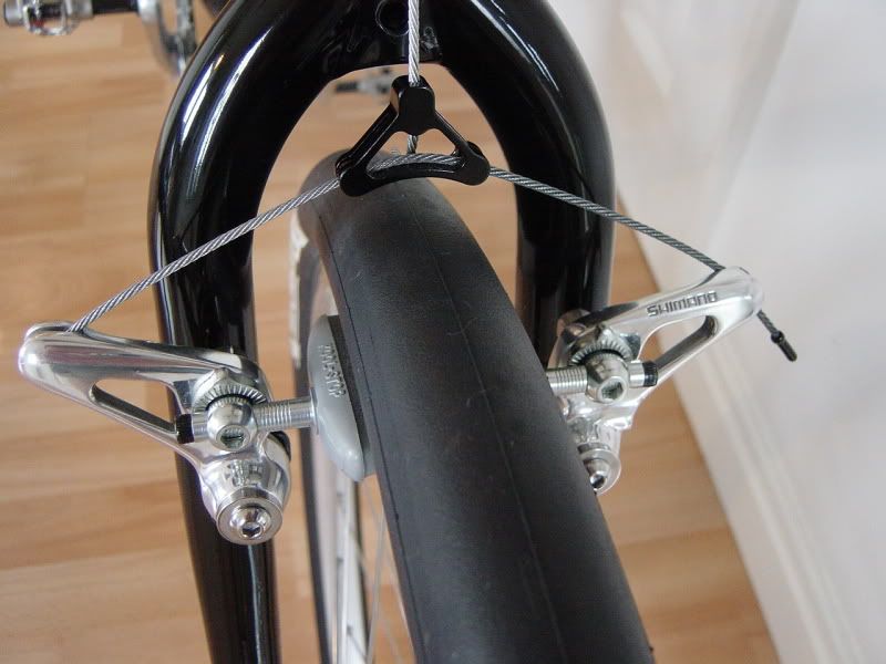

That is a err naff noise. BiTD I used clear pads on my MTB and they didn't sqeak maybe due to using normal cantis on decent alu rims.
Not so good if you put a water interface between them though.
Do they still squeak like that on the modern BMX V'brake things they have now since they shouldn't flex forward like tht old caliper style.
(shows I know nowt about BMX's)
