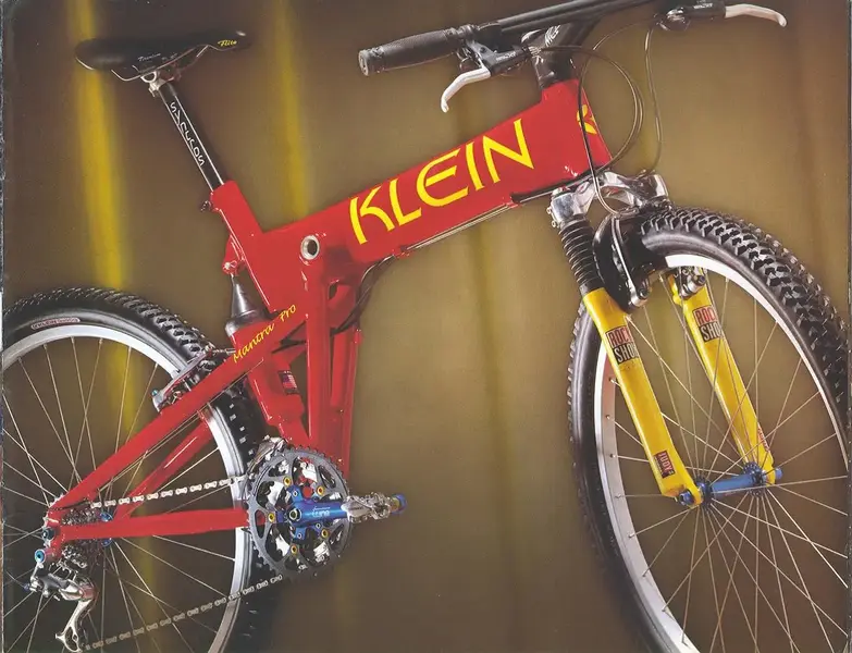

The specs says it has Avid Tri Align rear brake and Tune cantilevers on front. If you study the picture on p. 21 of a Mantra Pro in Deore XT Tune clothes in the same catalogue, you will immidiately notice that those front brakes are not Tune but simply Deore XT M739 V-brakes.
Next it should have a XTR rear derailleur (which must be M950) but same picture of Mantra Pro shows a M739 shifter.

Short version of original post is, that I discovered a version of 1996 Klein Adroit, that really suits my taste. To fully understand the build, I checked the specs in the 1996 catalogue and also found the attached picture of a "Tuned" Mantra Pro. Even though I am building an Adroit there are the same two differences:
Specs says XTR rear derailleur (must be M950) but picture shows XT M739.
Front brakes should be Tune cantilevers and rear Avid Tri Align, but picture shows XT M739 V-brakes front and rear.
I am wondering which is correct; specs or picture? Hope somebody can help as there is close to zero info on the internet regarding Klein Tune versions.

I won't claim to know much about Klein's but I wouldn't follow the build according to that pic you posted. Look's like the XT sti's they're using are for canti's and not for the V's that are mounted. Imagine you could be right when you say they may have just thrown it together for the photo shoot
Eagle eyes, Canuck! :)
For 1996 there were two versions of brake/shifter combos in Deore XT.
ST-M738 was intended for use with cantilevers, and ST-M739 was for the newly launched V-brakes.
Specs dictate Tune cantis on front and Avid Tri Align on rear, so I got a nice set of M738 shifter/brake combo coming in from across the Atlantic from my friend James :D
Have been wondering a lot about the rear derailleur for that simple reason, that I personally think, it will look strange with a XTR M950.
With M950 Shimano introduced a new finish in a grey-green tone, which would look misplaced up against Deore XT M738/739, that retained the retro silver look.
There is no doubt however, to my mind at least, that the "Tune"-version was successor to the special lightweight from 1992, which mainly had Suntour parts mixed with Dia Compe and Campagnolo. Tune being specialists in lightweight parts and selling Tune-Up Kits for weight saving purposes would make an ideal partner. The addition of a XTR rear derailleur could be for the same reason, ie weight saving.
If you think it from a business point of view XTR adds significant costs for the manufacturer :? One way to get around and still hold true to theme of light weight could be using the then newly discontinued M910 rear derailleur instead of M950. You would get looks that were more in line with the Deore parts, weight savings and you most probably could get it cheaper than a M950 as a stock clearance sale from Shimano. Only drawback would be limited stock, but I assume this special version would not be a top-seller due to price.
