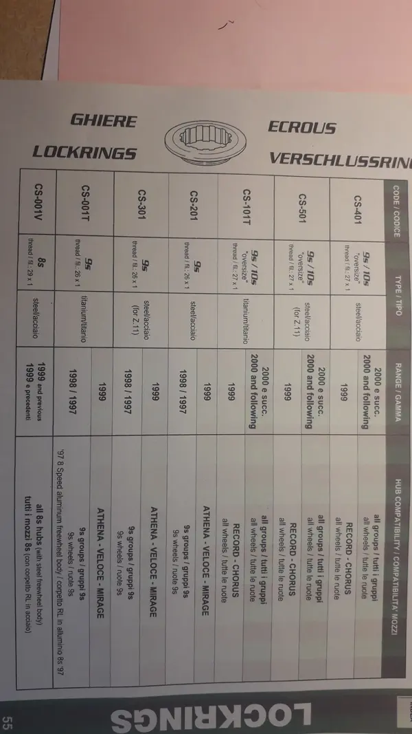

Yes they have a 26mm thread opposed to the more common 27mm. The CS-201 and 001T fit 12 tooth cogs and upwards, I believe it's the CS-301 that fits the 11 tooth. They fit a freehub that Campagnolo only made for a few years in the late 90's.
I enclose chart from campagnolo
hope this explains things
Z.11 is for cassettes where the small sprocket has 11 teeth (the outside diameter being smaller)
I think my CS301 is the one Clemenzo in the link above. It is alloy and for 11t.

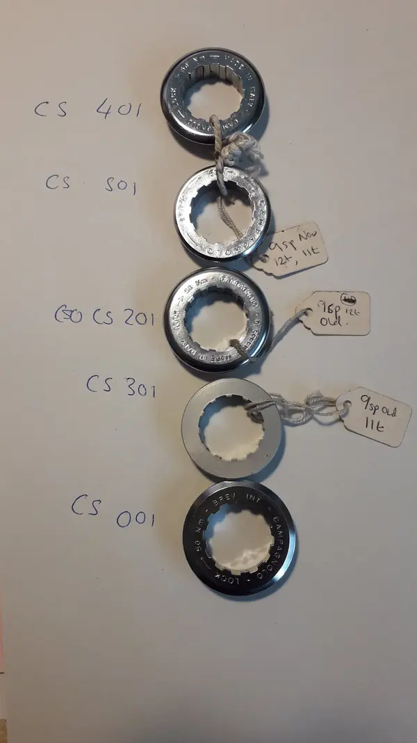

26mm I have one CS301 fitted and one spare CS201 and CS301(alloy)
The chart is available from campagnolo spare parts and tools catalogues that can be found easliy in the early 2000s time period.

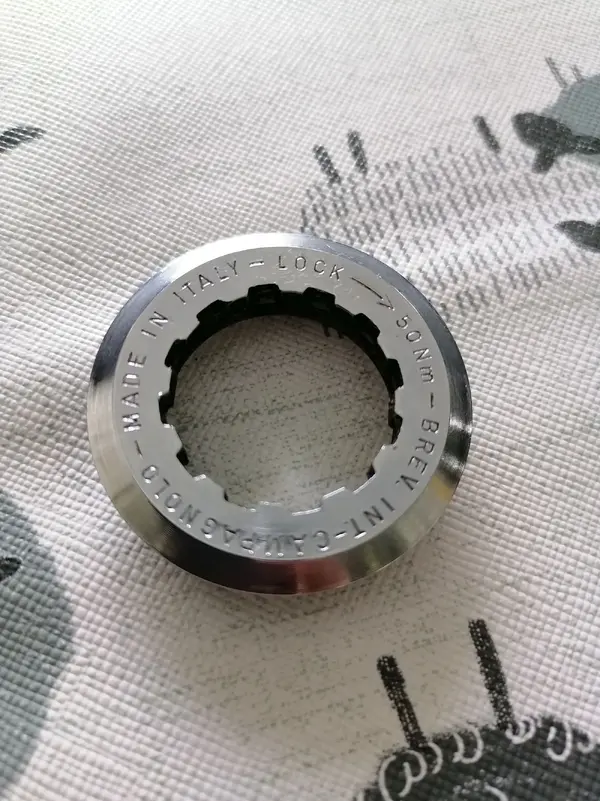

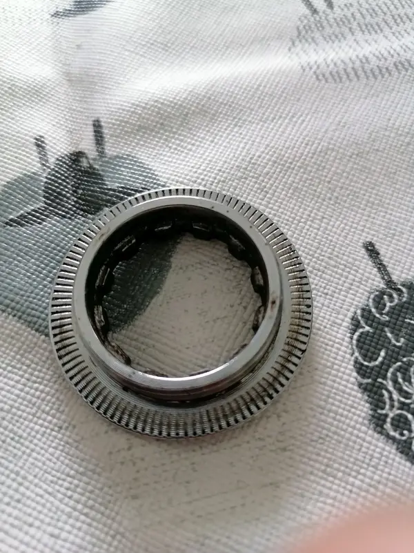

From the picture, here is my long time on the shelf CS-001, if it is of any use to anyone?
