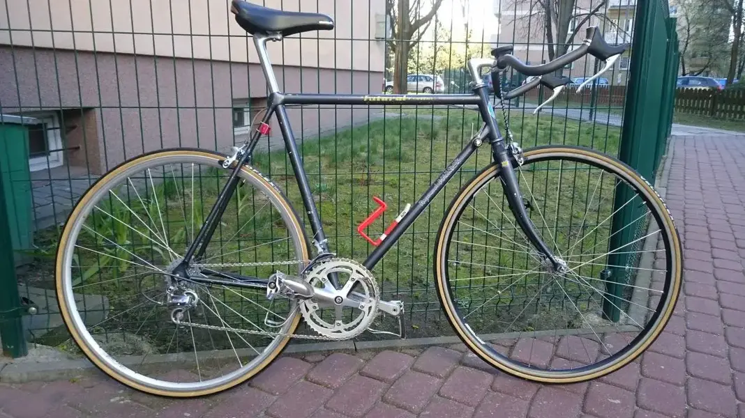

I am the owner of Vitus 787 Futural. There was a time I intended to sell it but then I came accross this picture which also inspired me
The one from the picture is equiped with Shimano groupset. Mine will be 80% Suntour SL. Suntour SL is relatively cheap (compering to Superbe Pro) and lightweight groupset. According to Suntour catalog, SL groupset is described "...SL components are the choice of road racers and triathletes alike".
