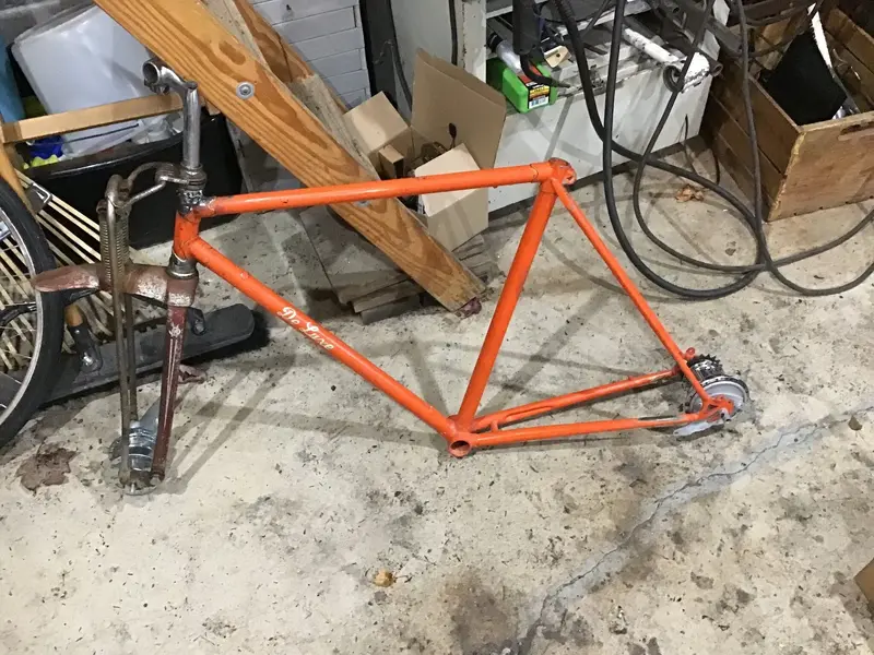

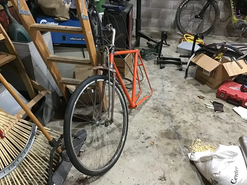

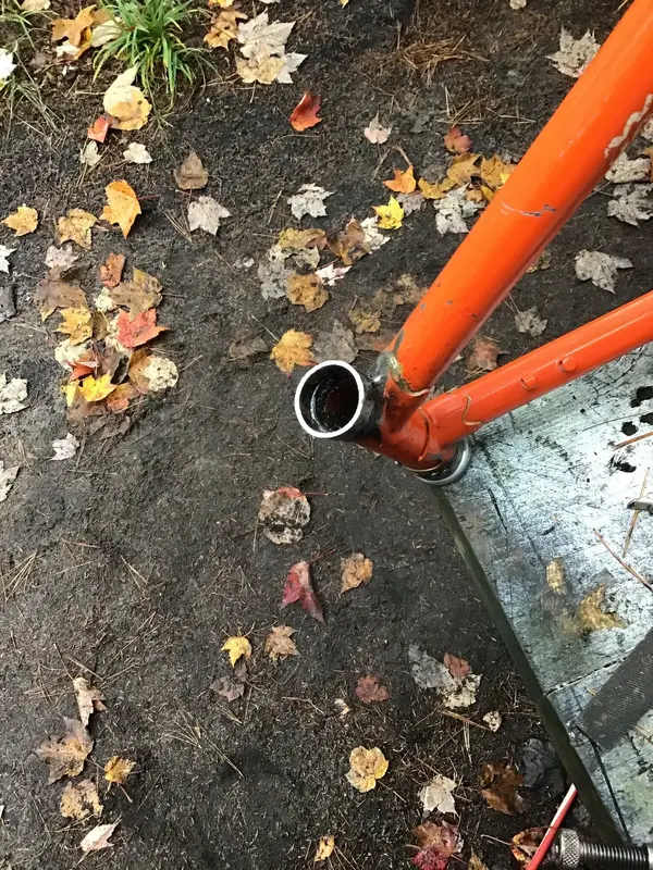

I started on this bad idea today. It’s raining but warm so I could use my shop. The springer fork I‘m trying to use has cups that are too big for the frame and the head tube on the frame is way too short for my springer. I tacked on some head tube pieces I hacked off one of the frames in my frame fence. These pieces have the right diameter for the fork cups and this added the right length. I still have to ream and face the extensions. Perhaps I’ll do that tomorrow. Almost all my bikes, even the nice looking ones, are Frankenbikes. I like to buy old frames, collect old parts I like from vintage bikes and make something. I like this site because almost all the bikes are beautiful restorations. For some reason I seldom restore a bicycle, especially if I can make a better rider out of it. This project will be my winter entertainment. IMG_4255.jpeg
Here is the fork I’m trying to fit to the jury rigged head tube. IMG_4256.jpeg

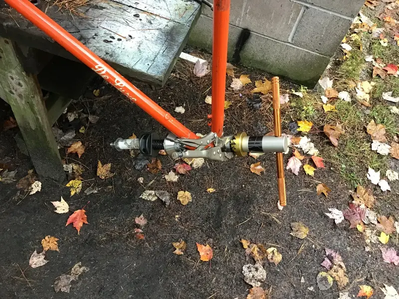

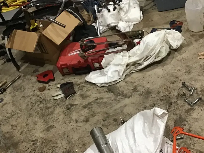

I just figured out what happens when an irresistible force is applied to an immovable object, it gives. The head tube reamer had a hard time getting started so vice grip force was added to assist the reamer handles. Get er done. IMG_4262.webp IMG_4263.webp
The dang cups were tight. A sledge hammer on an anvil fixed that. Now I know my tack welds on the head tube extensions are good. IMG_4264.webp

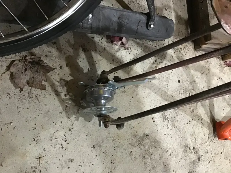

The wheel size I want to use fits the fork with plenty of room to spare. These old springers didn’t have a lot of travel. The clearance is tighter in the rear, but still good room around the stays. I think a fender will also fit back there. IMG_4275.jpeg
Sachs drum brake hub.

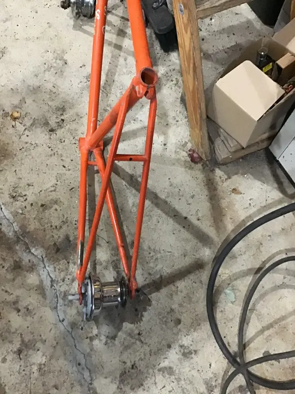

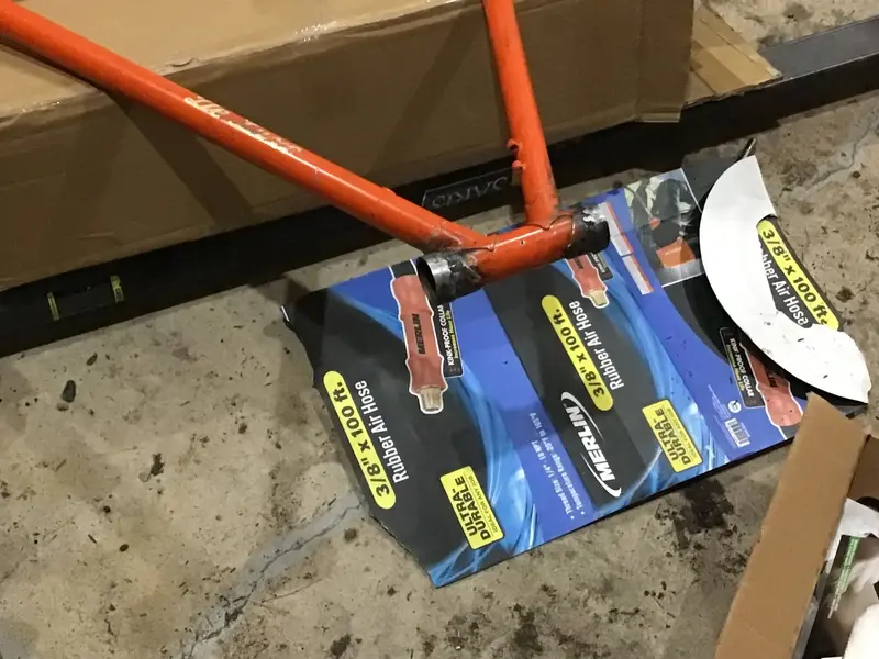

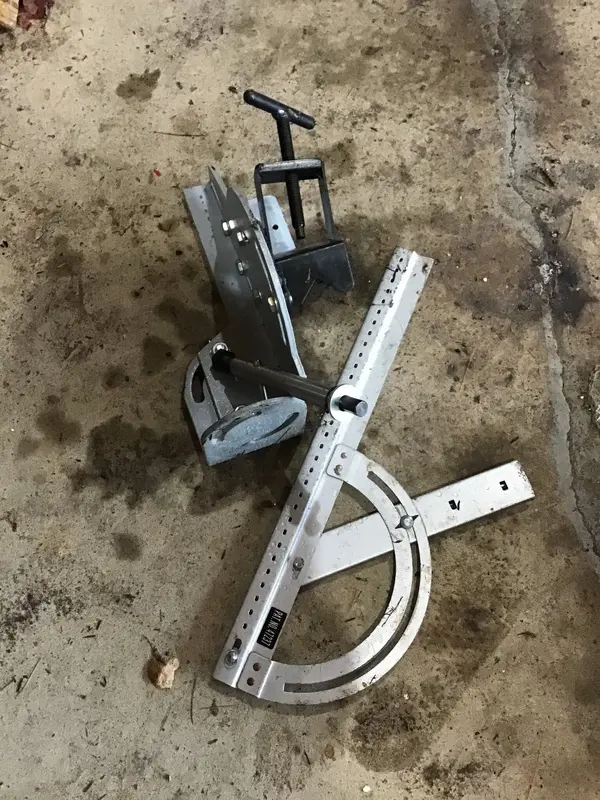

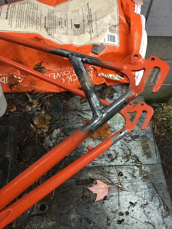

I’m the worlds worst pipe angle coupler. Even with protractors and a pipe cutting jig. I gotta say though, this is my best fitting attempt so far, but not by much. IMG_4294.jpeg Now the hacked off chain stay, from a donor frame, is a drum brake frame brace, held on by welds by the worlds worst welder. A lot more filing has to be done. I have a few more things to weld on but it’s supposed to snow all weekend so I don’t think I’ll be doing that. It would look better if the donor frame had smaller diameter stays, but I didn’t feel like removing another frame from my frame fence. Good enough is perfect around here. This bike is going to be a freaking mess. It already weighs a ton. I think the only parts I’m using that are not steel are the shifter and perhaps the pedals. IMG_4295.jpeg

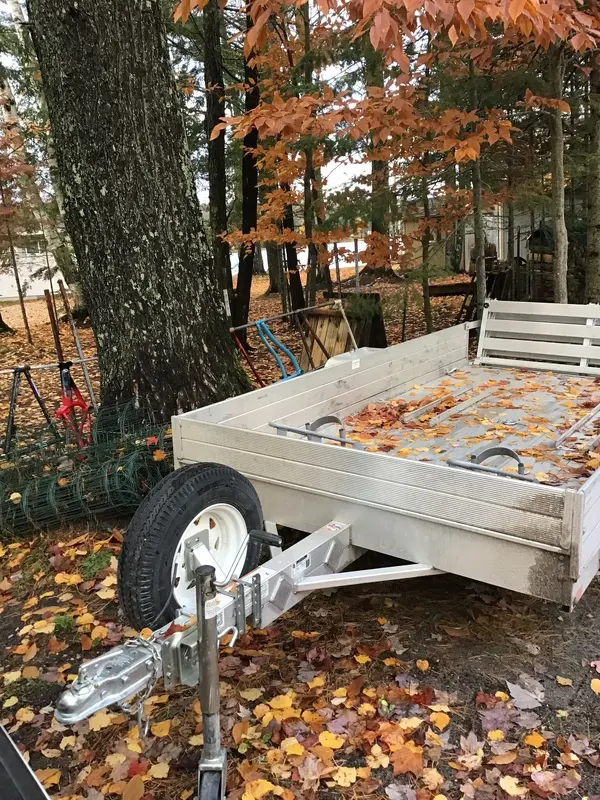

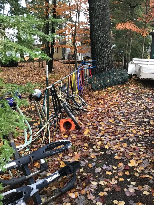

My frame fence is my hack bike frame parts stash. In the winter the frames are frozen solid into the ground. This makes it easy to cut parts as they don’t move. IMG_4297.webp IMG_4296.webp
