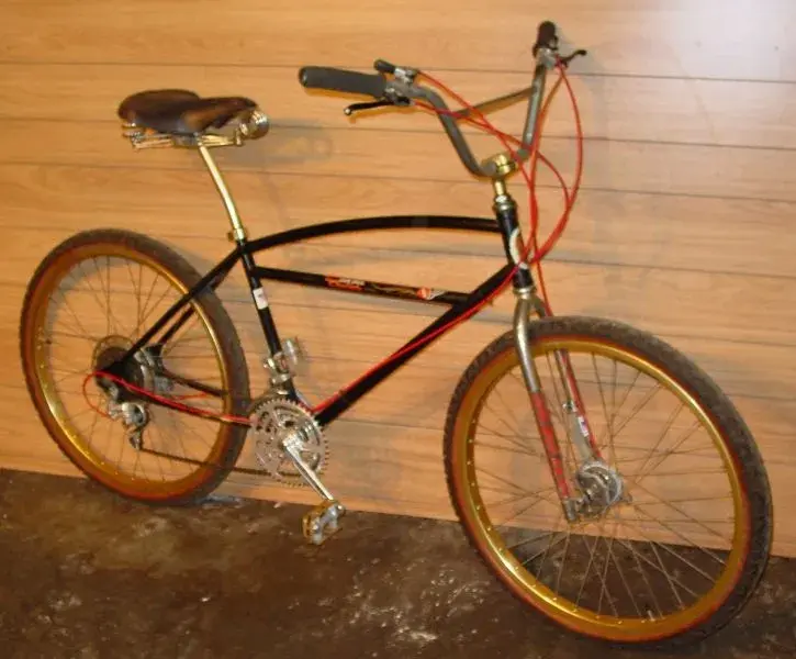

Correct me if I’m wrong but they look like they’re simply Specialities TA Cyclotouriste cranks. Used on early mountain bikes including the original Stumpjumpers because there was nothing else available to provide the low gearing required. A quality crankset undoubtedly but not that rare as they were a go-to for touring bikes (and tandems) from the early 1960. Still plenty of them around even now. Probably not that many unused sets knocking about to be fair.
https://velobase.com/ViewComponent.aspx?id=19692c31-4452-4c95-aa38-f7da41cdbafa
You are 100% correct!
I just posted a picture of one of the vintage "Klunkers"in my collection. The American made crank arms that I was/ am speaking of were originally for BMX and the company that made them produced a spyder to take the TA rings (VERY RARE). Honestly the first Mt. Bike specific cranksets ever made.
I am sorry for the confusion!
