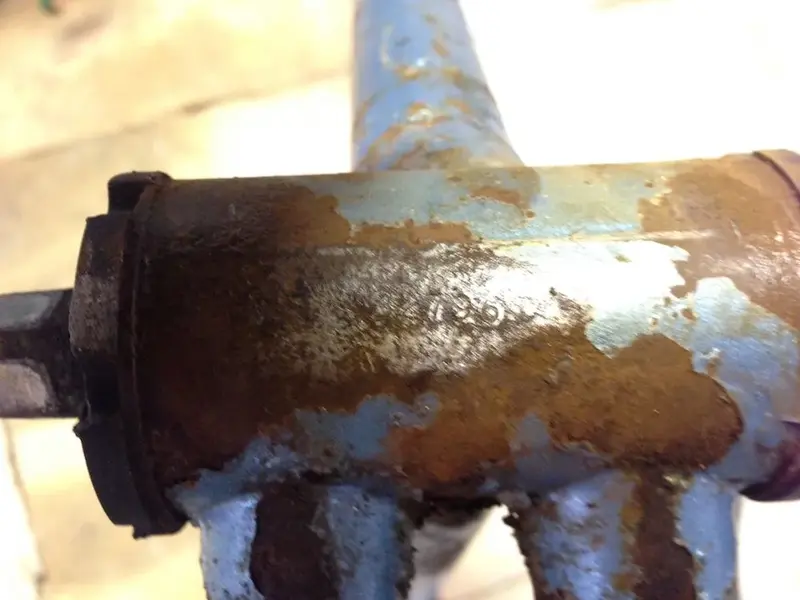

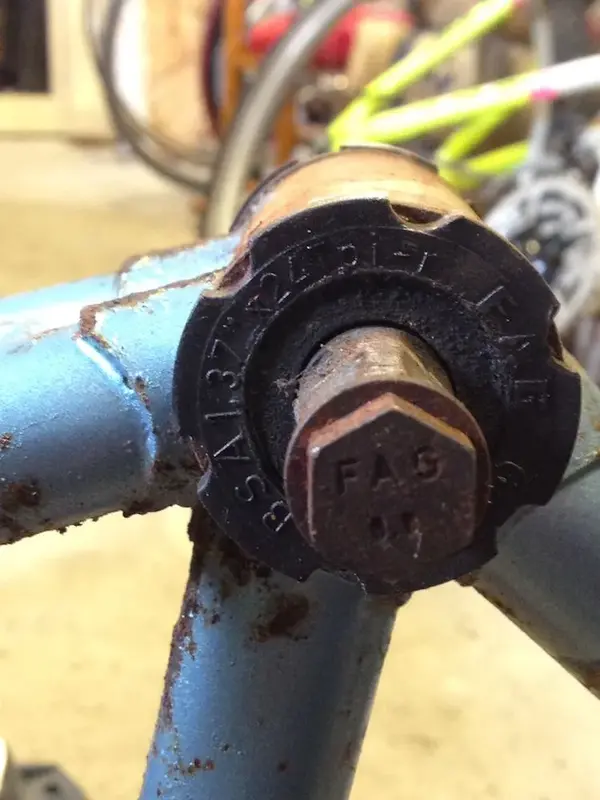

Here's the photo's of the BB and serial number, It's 32796, there's also an F on the other side.
Thank you pigman, that would make sense, it did have the 500 brakes and some gran sport bits, the stem is SR with a viking handlebar.

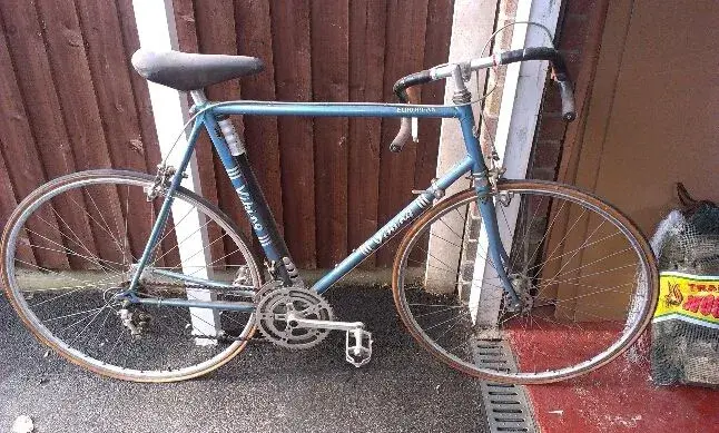

My mates had one of those from new 1982 I think. Came with gran sport and weinmann mixed group. Got a pic i'll post
