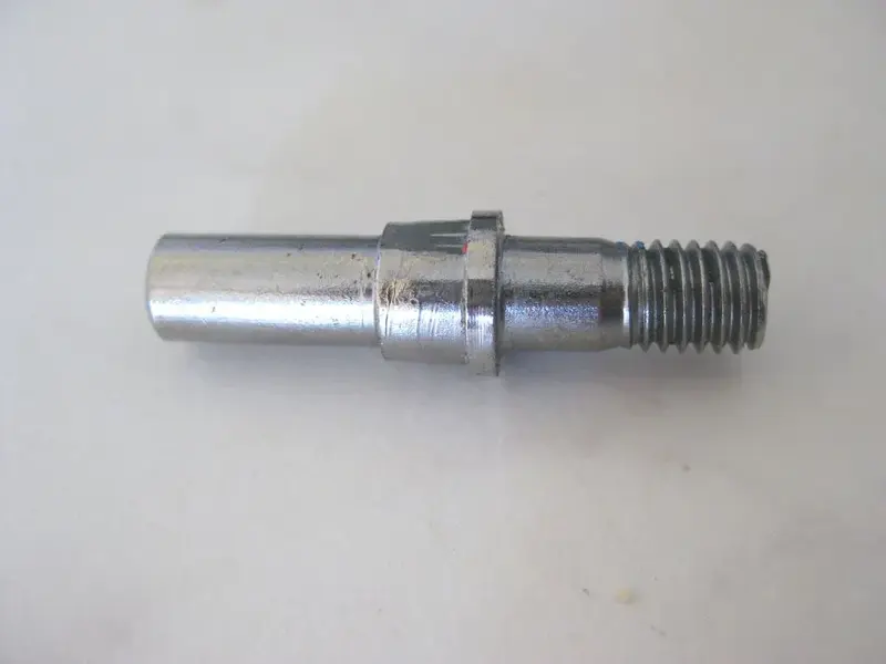

On the part of the fork where the bosses go in, does the threaded section start straight away, or is the thread recessed further back into the mount? It was on my old RS Judy - if you need that type I should have a set.
Yeah it does make a difference (as I found to my own dismay!). If the thread starts straight away you need something that looks like this:
http://www.ebay.co.uk/itm/2pcs-M8-V-Bra ... 0283483778
If the thread is recessed you need a slightly different looking one, I'll try and post a photo of mine in the morning.
It is a bit hard to believe just how difficult it is to find brake bosses. Here's the M8 pair I have - the section between the 'lip' and the thread means it's only suitable for forks where the thread is recessed a little way into the fork (the old Rockshox were, certainly). You can hopefully see the difference between these and the ones in the ebay link I posted.
