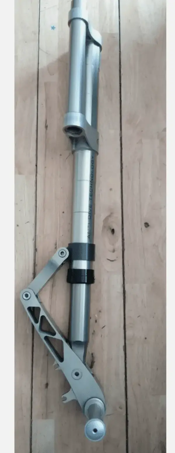

USE Sub fork...with issues

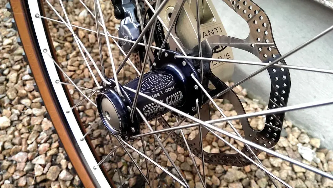

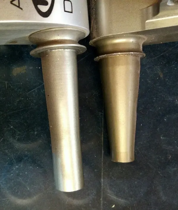

Yes, looks like that one needs the special USE hub, although IIRC Hope made a conversion sleeve for their Bulb hub for it, too. Takes the 20mm ID bearing down to 17mm ID.
USE did later make a Cannondale Lefty compatible version, with the bigger taper up to the big LH bearing, so at least those hubs would be easier to find.
USE-specific version on the left, shorter, more tapered Lefty version on the right:

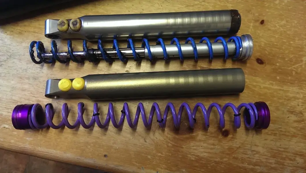

Leg seems devoid of anything so looks like it would need an air cartridge, spring and a hub
I rebuilt mine not long ago…. so I thought…. it was 2014!!! Where has the time gone?!😕
Hi Roy, they were indeed mine, I had two of these over the years, but were sold a few years ago now… sorry!
USE were able to supply me with with all the parts I needed, but as I said, that was back in 2014… no harm in asking them direct?
Now I remember your build of the Tranny , have tried USE but no parts available 😱 thanks for your reply.
All the best Roy
