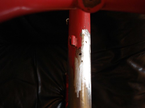

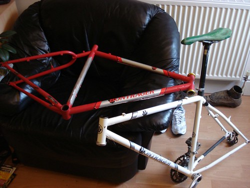

a while ago i had noticed a bubble on the seat tube of my Race, recently i noticed a few more. Did a bit more investigating, involving sanding the seat tube and was met with half a dozen holes where the frame has rusted through from the inside.
The parts are being transferred to my Bonty Privateer,
But i then have a frame, which for sentimental reasons if nothing else i don't want to loose. has anyone been in this situation and what did they do?

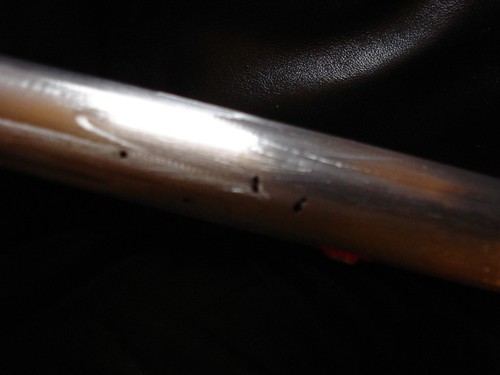

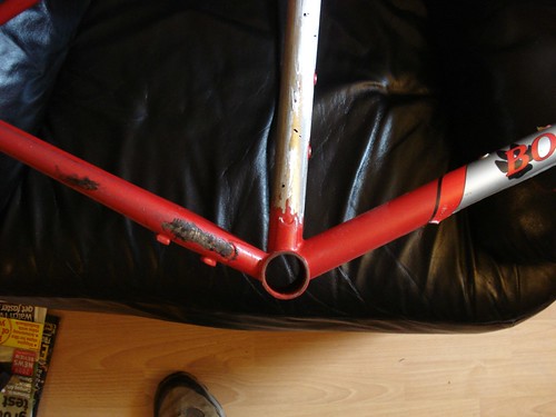

piccies
not very clear, the holes aren't very big but they are there and there are a few.

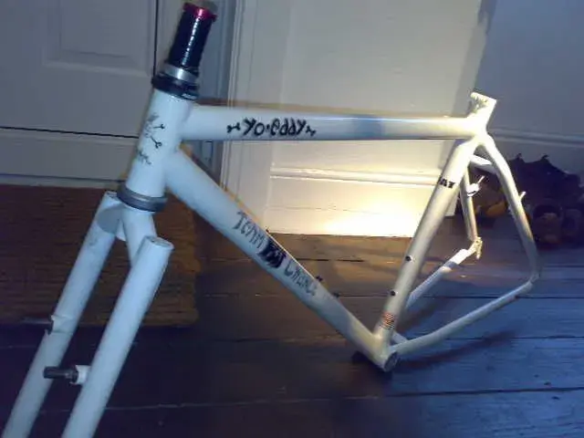

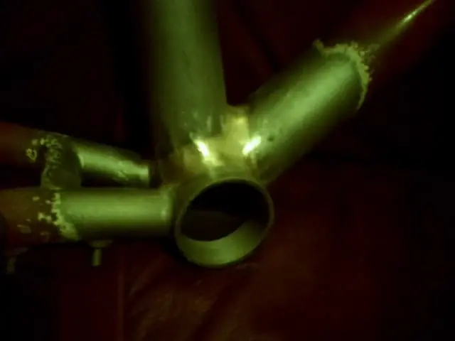

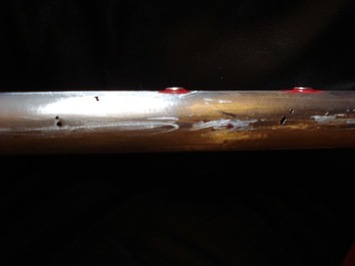

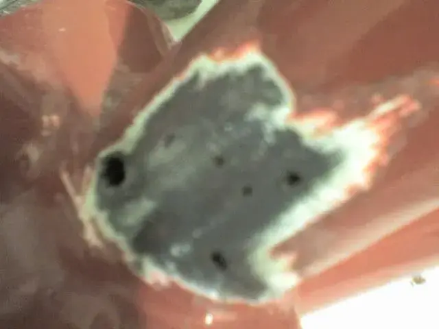

Same happened to my monster and my yoeddy,heres a few pics ,just try to keep the faith
What sort of condition is the rest of the frame in? You might find the same issue on other tubes.. :(
Sorry to be negative.
