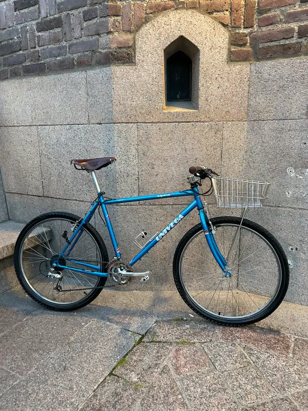

Definately, i’d rate univega frames at the near borderline between comfort creeping slightly towards the low compromise territory. At least the steel/cromyl steel tubular framed examples i’ve experienced anyway - which isnt a bad place to be on a budget priced (intentionally marketted) example.
