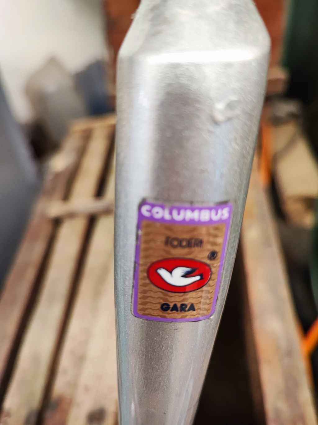

So here is an unidentified 64cm frame, purchased on leboncoin (a French online platform), supposed to be fast. I haven't weighed it yet, but it doesn't weigh much.
It seems to be in "fairly recent" standards since I was able to mount a wheel with a 130mm spacing without needing to adjust anything.
Yes, it has probably been repainted with a quick brushstroke.

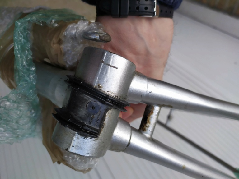

And once that is disassembled, I will need to find the right tool to remove the bottom bracket, which I have never encountered before...
Chainset is a Shimano Ultegra 6500 9 speed. Guess it came without the self extracting crank bolts? Bottom bracket is a Shimano Octalink version so the Park Tool BBT 32 will fit.

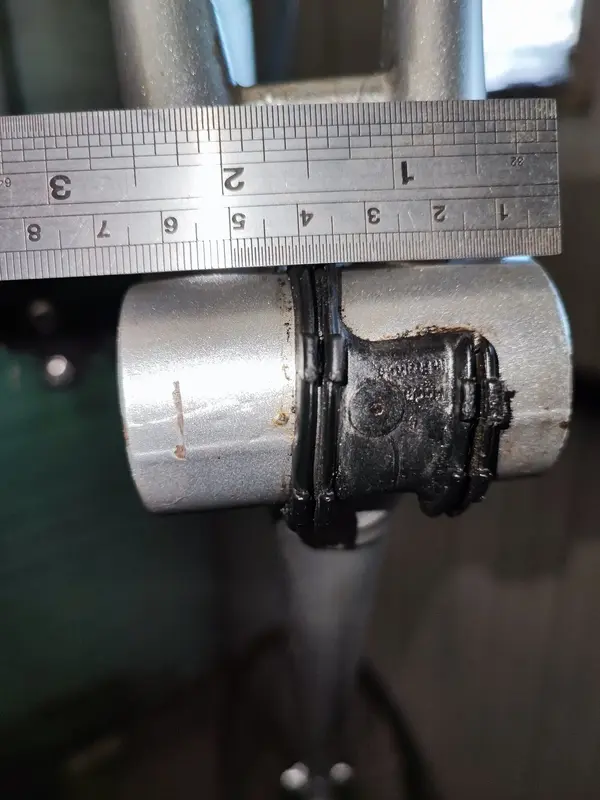

Is it italian 70mm or British 68mm thread bottom bracket?

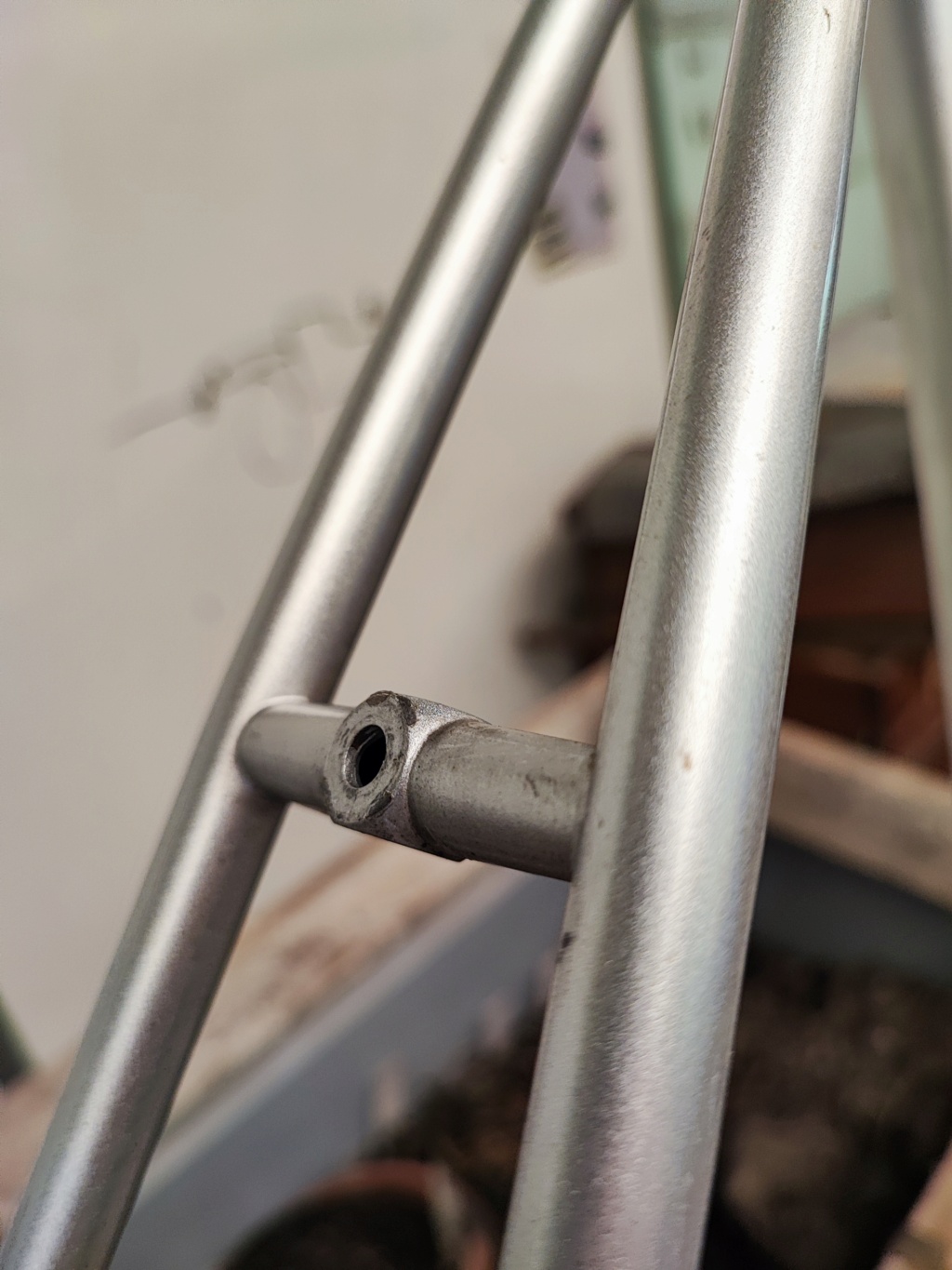

interesting fluted top and down tube. Possibly a small French, Swiss or Belgium builder?...Maybe Italian, but don't see many dual mudguard eyelets on italian frames.
I measured with the digital caliper, but I found numbers that don't correspond to French or BSA IMG_20230429_193402.webp IMG_20230426_140135 (1).webp (except for the 68mm)The problem may be in the caliper itself, or in my head, who knows...I think it's in the BSA standard, but I don't have a bottom bracket in that standard available. So, I'm waiting for the next delivery to learn more.

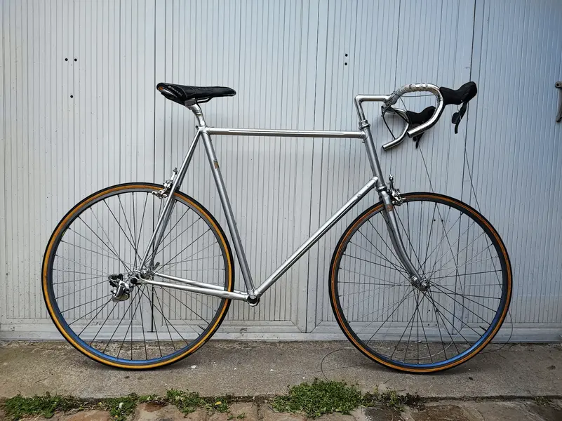

Thanks to a very generous member of the forum, I now have new (to me) wheels for my frame! 😍
For those who are curious, these wheels feature Dura-Ace 7700 hubs with 36 holes (HB 7700 + FH 7700) laced onto MAVIC Reflex rims, paired with Vittoria tubular tires.
Interestingly, the rims look different from what you can see in the picture. They have more of a black-greyish chrome appearance, rather than blue as it looks just below the text. 🤷‍♂️
I already have a set of 7700 hubs on another bike, and I adore the subtle, low-level sound that the rear hub produces. However, this particular rear hub doesn't make any sound at all. 🤤
