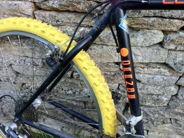

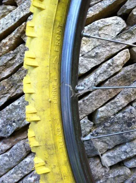

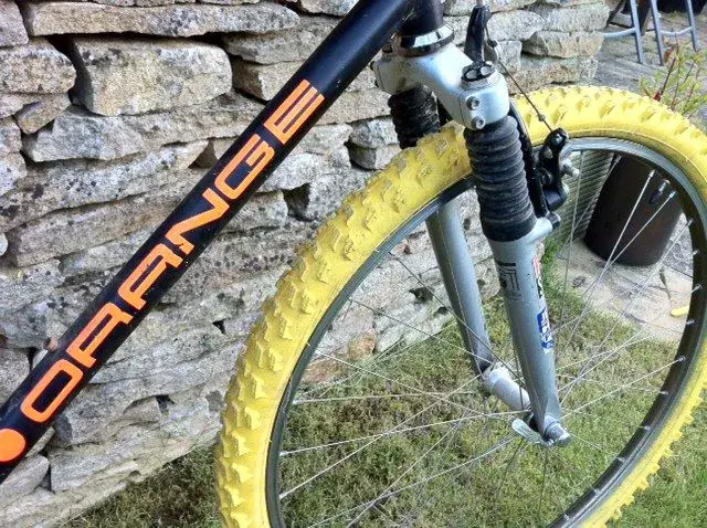

I have just bough a Clockwork. It has markings on the tyres which I am a little unsure of and indeed wonder if they are fitted correctly. Google throws up mixed messages.
The following shows the tyres as fitted and the markings.
Both fase the same way, and rotate forwards towards the word Front

the one on the front needs to rotate towards the arrow next to the word "front", and the rear tyre needs to rotate towards the arrow next to the word "rear" if that makes sense
So, looking at the top photo, the front tyre wants to rotate clockwise, and the rear one wants to rotate anticlock? This means the rear is on the wrong way around

In general a chevron pattern like that can be used for front and rear when run in opposite directions.
A very basic font based diagram:
:R--F:
With that config the rear tire's backward chevron design gets grip up hills and under pedaling force. Going into a corner the front tire's forward chevron design allows the tire to hook up with the dirt and maintain some stability and bite.
