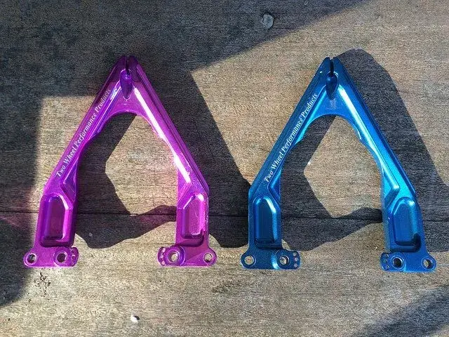

flipwils11 Devout Dirtbag Feedback View Oct 28, 2015 #1 Does anyone know if this TWP Rock Shox Mag brace will work on a Specialized FSX fork? Attachments image.webp 108.9 KB · Views: 336
F FSXStumpy Retro Guru Oct 28, 2015 #2 No, they won't. The Mag series forks used a brake boss as one of the brace bolts (as in this TWP brace). The FSX brace uses 4 bolts, above the brake bosses, and is much shorter, top to bottom. download/file.php?id=147581 J
FluffyChicken Archivist Retrobike Rider Feedback View Oct 28, 2015 #3 Re: As above for the Carbon FSX, but the standard FS or FSX fork then yes it will.

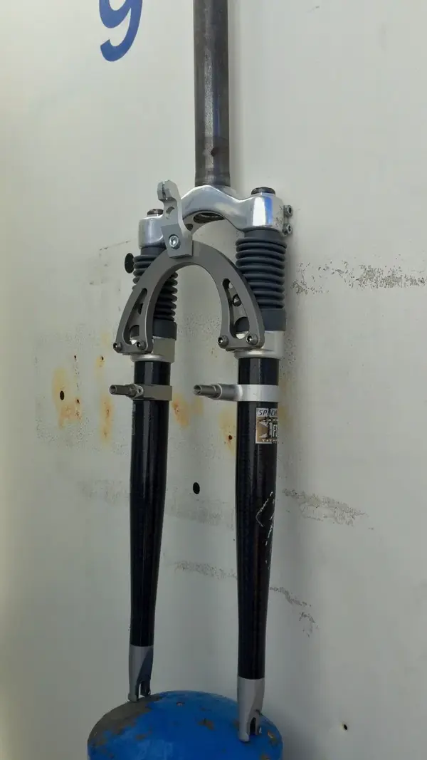

flipwils11 Devout Dirtbag Feedback View Oct 28, 2015 #4 Ok thanks, this is the fsx fork I'm using for my build and I was looking for some extra blue anodizing bling. Attachments image.webp 46.3 KB · Views: 301
F FSXStumpy Retro Guru Oct 28, 2015 #5 Doesn't work with them. That said, I've long felt that's a fork that doesn't need bling - It is the bling! Wonderfully understated bling. Pity yours doesn't have the alloy steerer. J
