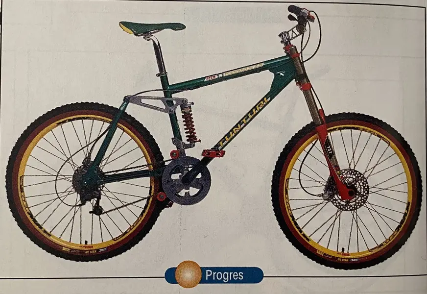

![Katalogi.jpeg Katalogi.jpeg](https://www.retrobike.co.uk/data/attachments/406/406110-a0840673a88631b76575b6e1d511a478.jpg)
I happen to have old Finnish bike magazines from late 90's so I managed to find a picture of the bike in the spec it was offered to the public. This helped me a lot with the part search, and also chatting with the old Tunturi team riders, from which I for example got the original stem for it. I think the hardest part to source was the green/yellow Flite saddle which I eventually found from Sweden, but the guy didn't want to sell it as he liked the green color. So in order to get it I offered to replace it with a new green saddle, and ordered him some green saddle from some online fixie store
