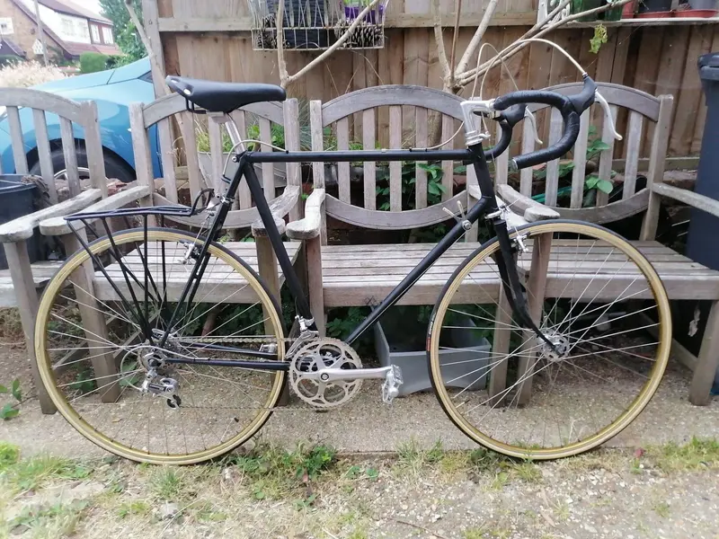

I'm trying to build my old 1947 Hobbs frame back up using all my 60s gear, in the back of my mind I think they were 27".

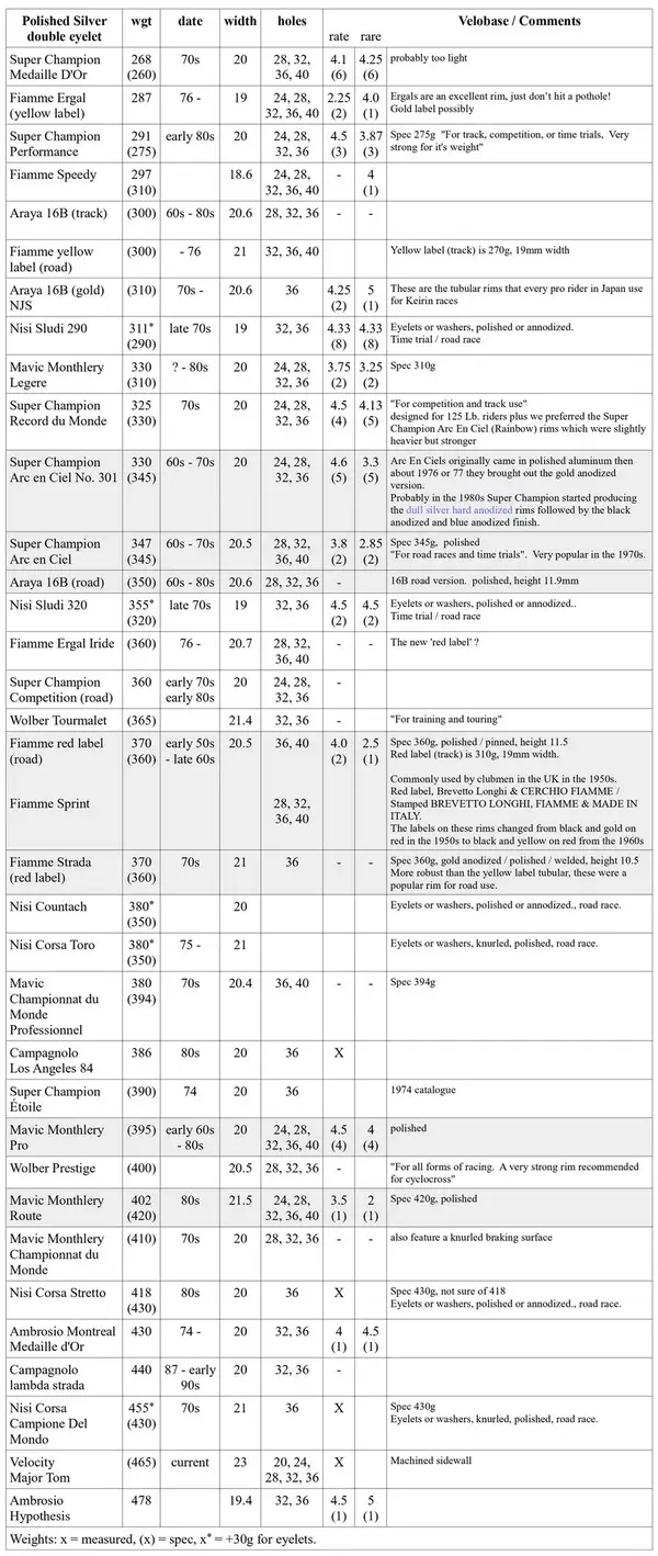

Here's a table of polished silver tubular rims I made recently - they are all 700c
