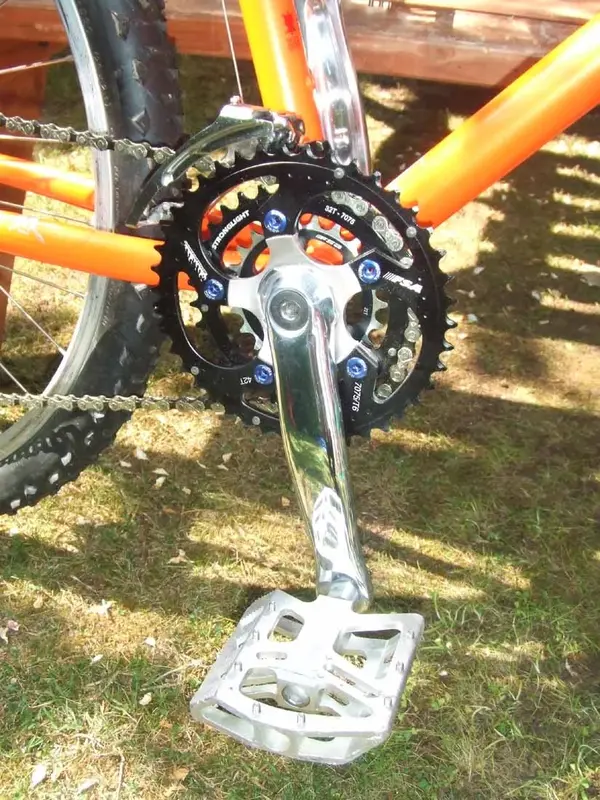

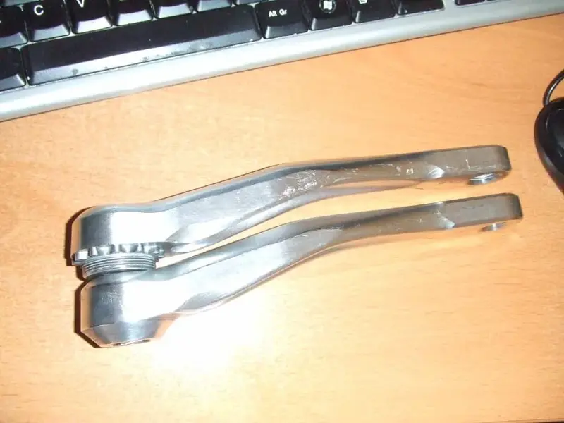

these middleburns spent 20 mins in oven cleaner then about 15 minutes gently with a brillo pad.

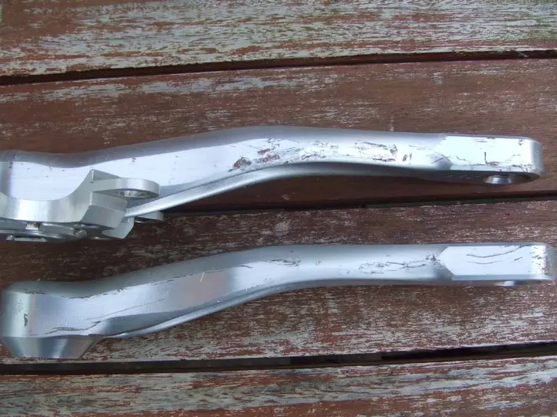

these were done by hand in the method described and actually began with some quite nasty scratches
