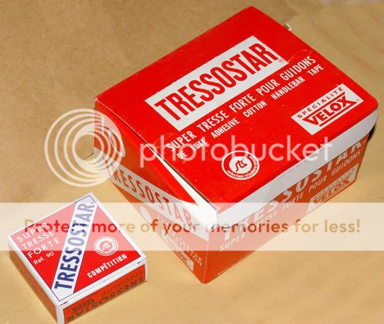

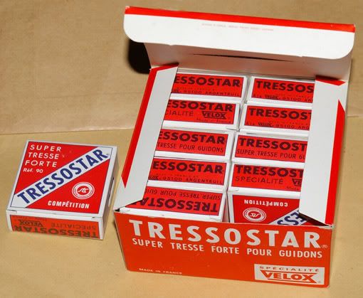

The packaging is just beautiful:
The tape is sticky, so no need to apply glue.
