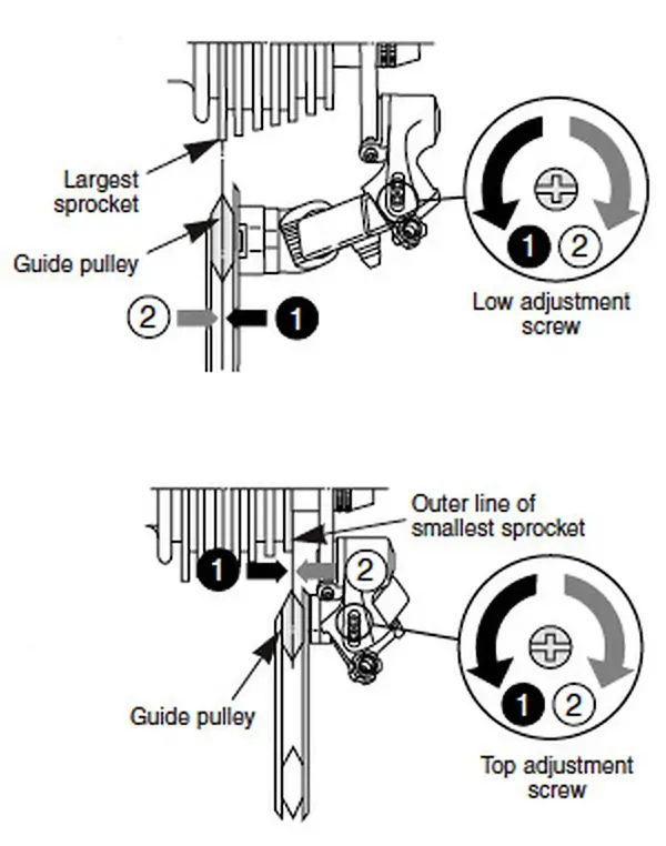

you adjust the screws on the back of the mech - they stop the mech from over shifting into the spokes or off the cassette and into the rear dropouts
Incidentally, these mechs will also do 10spd with a road bar-end shifter so dont worry about you 5 speed cassette!
