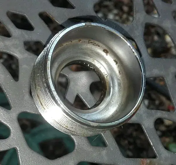

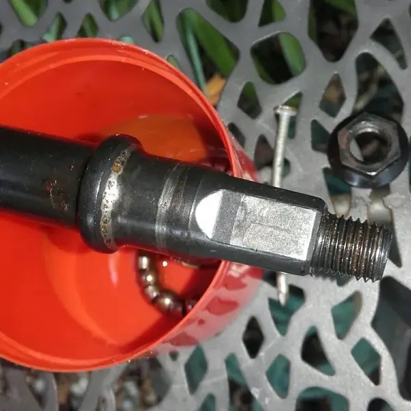

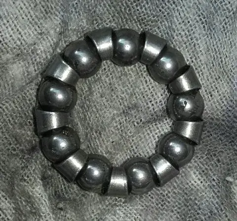

Success!
Although having seen what was inside I was tempted to throw it back together and pretend it never happened. :facepalm:
I guessing it's beyond saving?

Re: Bottom Bracket Removal?
Good job, now take some measurements and bin that lot....
