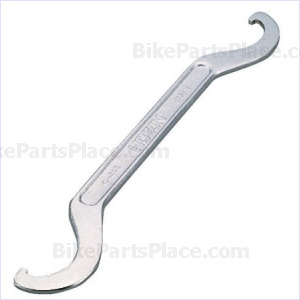

Pin spanner (they come in different shapes and sizes make sure you buy the correct size
Another version of pin spanner
Lockring spanner
A 6 pin removal tool would cost more than the price of the bike and very rare :shock:
Thanks,
I have the red pin spanner. The lockring spanner I have is not the right curve for this BB - this is where i am confused.
Richard
