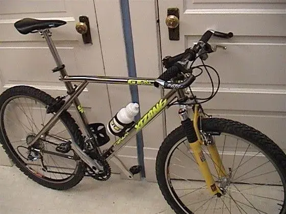

The ingredients in the polish do help to cut through the tough oxidized spots and the polish is a lot easier on the aluminum than medium steel wool. I might use medium steel whole to remove light to medium scratches but it's to heavy for a final shine. The polish I use is not a cutting polish but a finishing polish. There are numerous grades of abrasives in different polishes.
