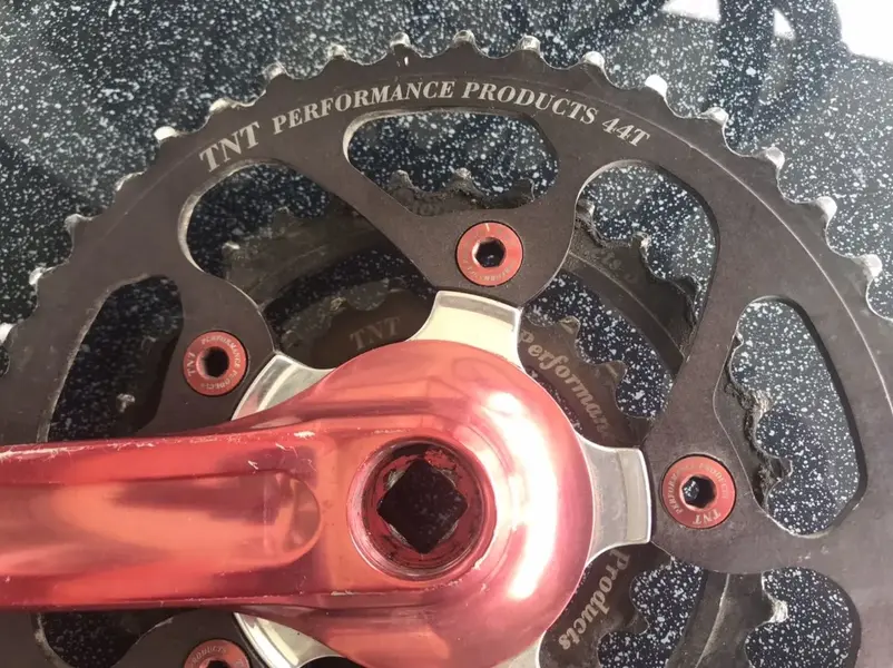

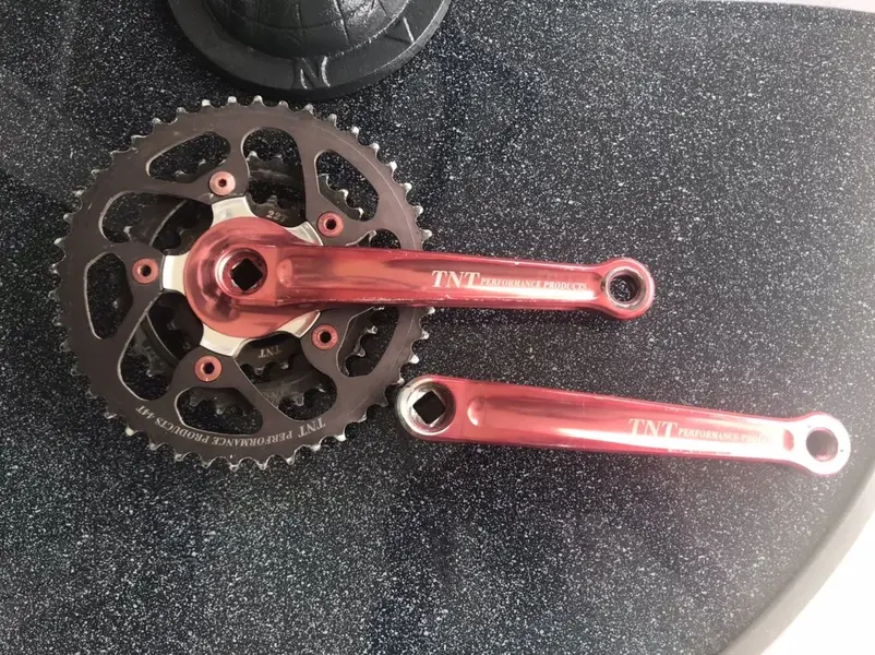

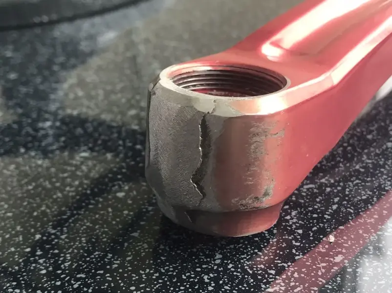

Picked up these cranks on eBay. Were for sale for quite a while. The non-drive arm was cracked some time in the past then repaired by whoever so I don’t entirely trust structural rigidity.

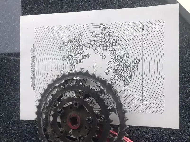

I was more so interested in the chain ring and bolt set. The seller insisted the BCD was 107 :D. I tried to convince him that was not possible so after going back and fourth over several emails I let him win the argument and he kept his auction listed as 107 BCD.
Some time went by. Maybe 8 weeks. Cranks still for sale. I reached out to him and made an offer far less than his buy it now. He agreed. Got the parts, printed out the Sheldon Brown 5-arm BCD gauge…and wouldn’t you know: 94/58 BCD. Now I have a nice TNT chainring set.
Crank arms are 175 mm.
Does anyone have a non-drive arm for sale!? Thank you in advance for any help!

Spoke with the previous owner and asked whether or not the repaired arm was ok to use. He said the crack developed a long time ago and he continued to use the cranks. I'll see if I can smooth out that repair area then reanodize them. I can use this set here as practice before reanodizing my Kooka and Grafton sets + rings.
For you old timers: with cracked cranks was this a product of over torquing axle bolts? Or installing square taper cranks onto JIS bottom bracket? Inferior aluminum used for production?
Could be any of the above. If I had to guess, a combination of imperfections in the alloy, the cnc’ing process (which cuts rather than forges the component into the desired shape) and probably a heavy or aggressive rider and the inevitable passage of time.
Would strongly caution against ever riding that NDS arm again, regardless of whatever story the previous owner spun you..
