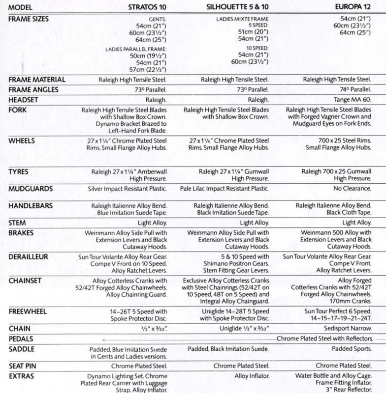

The ND frame number means it's a 'gas pipe' mass produced bike, as ones built at the Lightweight unit have a W prefix.
As I said, the pictures are from the 1983 brochure, and this was the last incarnation of this model, it had been running for a few years beforehand, and the spec and decals will have changed with each model year.

So bog standard tubing around 1983 then
Thanks for the info and the page posted helps
