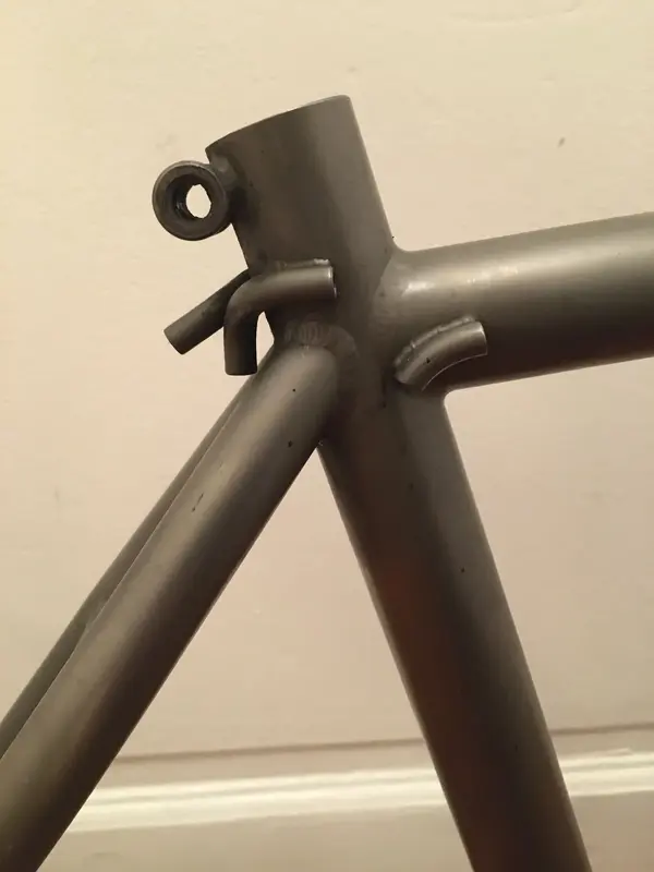

Hi all,
I picked up this unknown mid 90's Ti MTB frame... it has some very distinctive features (noodle cable guides) and i'm sure someone here would be able to help ID it (please see pics).
It's a size 19" and weighs around 1400g. The serial number that's partly unreadable (big scratch) starts with an A and finished with 22C6.
Besides IDing it i have a couple questions :
- there are shims on the headtube (top and bottom) : are they here to welcome a 1" fork in a 1/8 tube (and could be removed) ? Or to strenghten up this area (and thus should be left as is) ?
- Are Teflon hoses still the best way to run cables through this type of guide ?
Thanks !

Externally reinforced headtube and noodles suggests Russian made to my knowledge.

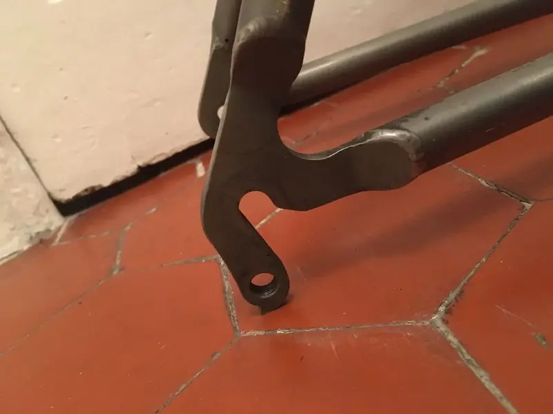

The dropouts look the same as those on my early Raleigh Torus annnnnd that where the similarities end...
My torus had nicer dropouts and wishbone stays. Cant help with the id I'm afraid but have you tried a headset for size? I've had and still have a selection of ti frames and some have had a seat post shim from factory, but none a headset shim. Not saying this was never done, but could be a reducer to allow a different headset size as you suggest.

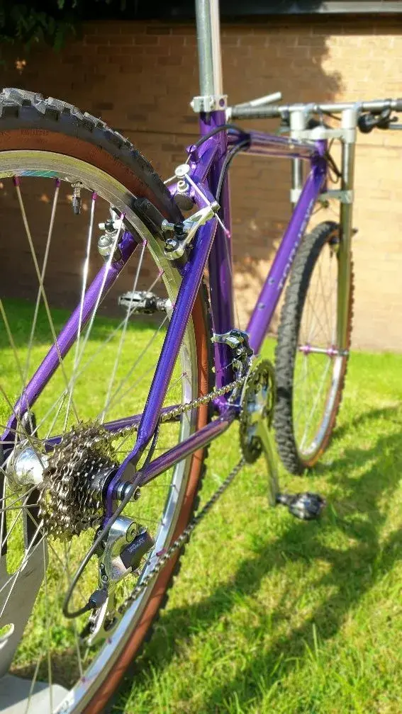

You got me thinking... i'm chatting bob, they are similar-ish but im now thinking the dropouts are similar to a mid-90s saracen I had... here is pic of my early '93 Dyna Torus...
Thanks for pointing Russian made. KGB Cycles made some polished TI frames with very similar noodles (model MIG 3.3). Any other ideas of Ti builders using noodles ? Can't seem to find much...
Regarding the shims : didn't find any pic of shims-reinforced head tube yet... now wondering : effective HT reinforcement should focus on the welds area instead of just tube edges (not much stress there ?). What do you think ?
Yes, unfortunately, love these Torus :)

Think it’s a DNA they came out of Russia.i suspect the shin in the headtube is for extra strengthening
Thanks. Coulnd't find a DNA model with noodles yet... As for reinforcement i'm still unsure (see above) will have to investigate furtther !

Thanks ! Apparently all 90's russian Ti frames came from the same source...
Any other idea of a builder that would use this type of cable guides ? I tend to associate 90's russian titanium with re-branded frames and noodles with boutique / high end stuff, so i'm facing a little of a paradox here.
