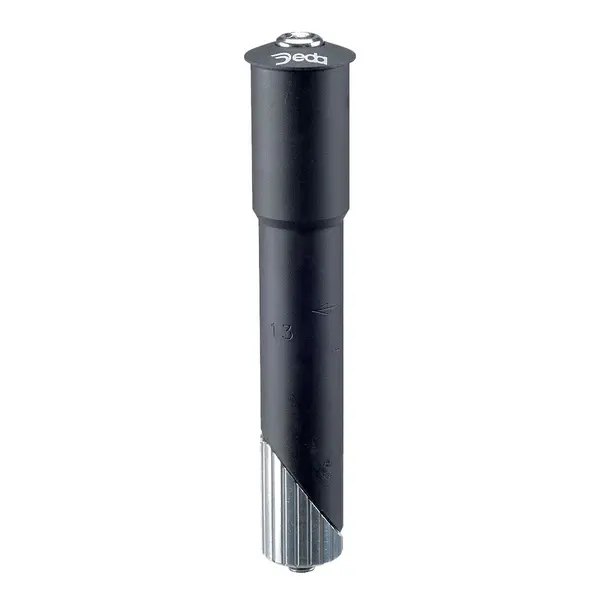

There are cheap threaded to ahead adapters available, they add a little weight but are a better solution to the problem than clamping a stem onto a threaded fork. Imo.

Yes, I've got one of those adapters on one bike but really I'm on the lookout for a reasonably good quill stem to replace it. My thinking is that clamping an ahead stem to a threaded fork is something of a last resort.
