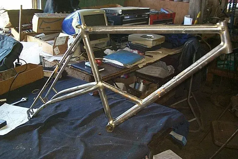

Just arrived and it is super sweet :)
I just noticed that the 2 Teesdale frames sold on E-bay do not have a bridge on the elevated chainstays! I read on a test in MBA from 90 that the earlier frames cracked without it :(
I would consider having one fitted while there is no paint on it,, a pretty easy job :wink:

Most of the Braves ive seen on the net have the bridge fitted..apart from the Chief and the other frame Tom sold..
I think if its going to be ridden, that the bridge is a no brainer :idea:

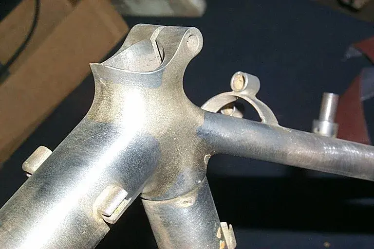

The bridge is at the usual chainstay location and up against the seat tube.
Think the problem was the chainstays flexing at this point (the ones without a bridge!) and leading to a failure..
I will post up a piccy of mine as soon as its done..
I refer to the Unpainted Chief and the Grove one that Tom sold himself..Like i said most others have the bidge allready there 8)
thats it
you got it :D
Have a look at the pics of the unpainted Chief and you will see the stays without it :wink:
