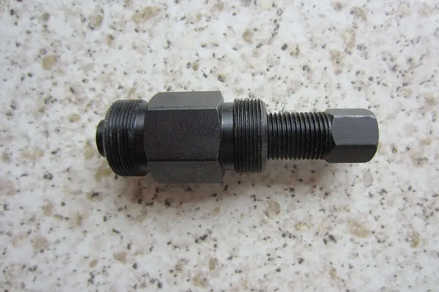

V Vetus Ossa Retro Guru Apr 3, 2024 #1 Can remove both TA and Shimano/Campag cranks, 22mm and 23mm thread. Only used once to remove my crankset from frame. A useful tool to have in the tool box, but not for me alas anymore. EDITED AS INFORMATION WAS INCORRECT. £15. Attachments IMG_5051.webp 188.6 KB · Views: 3 Last edited: Apr 3, 2024
Trotsky_Vulcan Senior Retro Guru Feedback View Apr 3, 2024 #2 If that is made by VAR....the 22mm bit will remove Shimano/ Campag, modern Stronglight cranks...the 23mm bit will remove TA Cyclotourist cranks...but Stronglight 49D cranks is slightly different again being slightly bigger than 23mm. It is an excellent crank remover!
Trotsky_Vulcan Senior Retro Guru Feedback View Apr 3, 2024 #4 Vetus Ossa said: Thanks for the info, I did use it to remove TA cranks. Click to expand... Me too...it works faultlessly.
