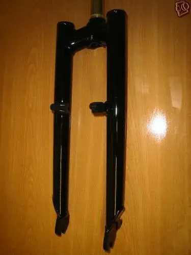

thanks me and mate had a look at orig bearings look shagged ..so need to replace them my mates off to a bearing expert this week to replace ta ones the shell and axle are in top nick silver alloy looks retro anyway ace...number on bearing reads 6903 2rs is that what i look for ? ref number bo-006cheers hopefull get back on the road next week its taken me ages to sort this old orange out..ta dont seem to do replacement bearings on there site ? more freaky pix coming thank you for your info ..we should all get a mass meeting of retro cycles some day weekend of beer and bikes be ace ps are these forks any good made by the same factory as onza ?
