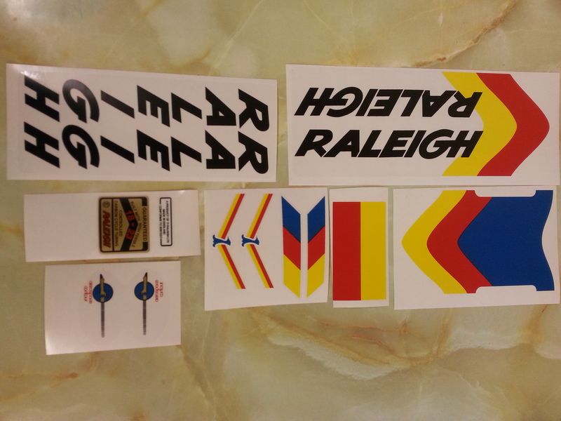

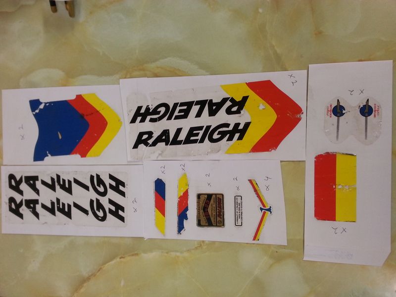

For the decals if you can peal them off and stick them on paper I use this guy and his work is faultless
[email protected]
He will copy and re-produce them.
Here are some he did for me
Originals peeled from bike
New ones he supplied
Or you may be able to find them on line.
Looks like original, will contact him thanks.
