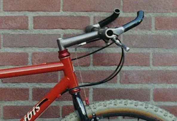

MRC I would say...
I had a quill MRC stem of 145x0°x1" (see picture) that weighed 163gms (with little tuning)...
I know they made 'm in Ahead in lengths of 135 and 145.. and I would like to believe that these are a lot lighter than my quill stem..
...the only thing... they are quit rare... :?
