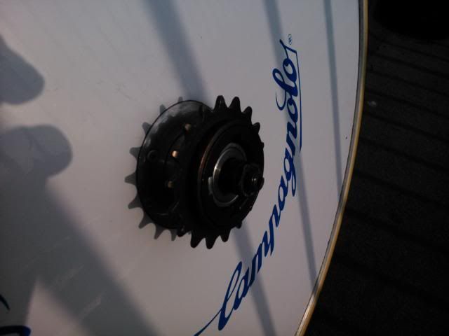

Hi, I'm looking to swap my Khamsin rear disc wheel. It is configured for track use with 120mm rear spacing and a single speed cog, fitted with a brand new Vittoria tubular tyre. The condition is good overall, the discs are very clean and hub is clean, solid and running smoothly. The rim is marked in places and the join has moved about 1mm from flush.

Is it threaded for a cluster on the other side under that cap, It's got a hollow axle for a Quick release i see ( i have one here in Australia with threads on both sides)
I hadn't noticed that, I think I could potentially convert this and use it on my geared bike but I imagine finding a longer axle and an expert to do the work might be beyond my patience (and my budget).
120mm OLD just constrains you to 6 speed freewheels , with some extra spacers on either end of the axle you can get 126mm and 7 speeds , on paper if you can get up to 130mm you can fit 8 speeds but as the dish of this wheel cannot be altered(compared to spokes) i think that will be a struggle
But where would I find the axles? I wouldn't know where to start :? Nice to know it's possible though, I'll be looking out for the chance to convert it while I still have hold of it, but I'll sell/swap it on if there's any interest in the meantime.
why buy an axle , there is plenty of length to put spacers between the cones and locknuts ,its a nice old style disc wheel but tubular tyre punctures are a pain for everyday use IMO
I don't think I follow, I know I can put 6 speed on this axle, maybe even 7, but the axle is still 120 and my frame is 126mm and I don't want to nip it together.
as above ....if you put 6mm of spacers between the cones and locknuts (eg 2mm NDS and 4mm driveside) there will be enough additional space for an extra cog freewheel OR you can still fit a 5 or 6 speed freewheel if you wanted , as long as there is ~ 3mm of axle sticking out past the locknuts both sides it will sit fine in any frame
