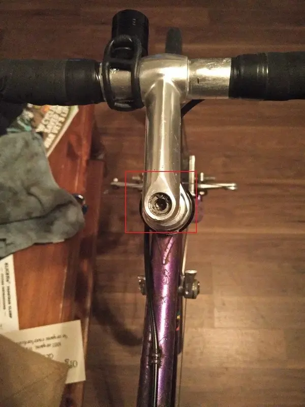

Hi guys and girls
I'm really happy with my new-ish retrobike!
I did notice on purchase that there looks like there might be a cap missing off the swan neck..
Picture below, hopefully someone might be able to help :)
Depends a bit on the brand of stem could either be a missing blank cap or it"s fitted with incorrect allen head securing bolt what brand of stem is it? & are there any fine threads in the top of the hole.
I think you could be right, I think there's a bolt missing! It does sound a little loose! Any idea of size or anything? :)
drewesq":3tkw25je said:
The Quill bolt for holding the stem is usually between 4&6inches long dependent on the stem length ( the part that fits in the fork column) the head takes an M6 allen key & the thread on the other end is usually M6
