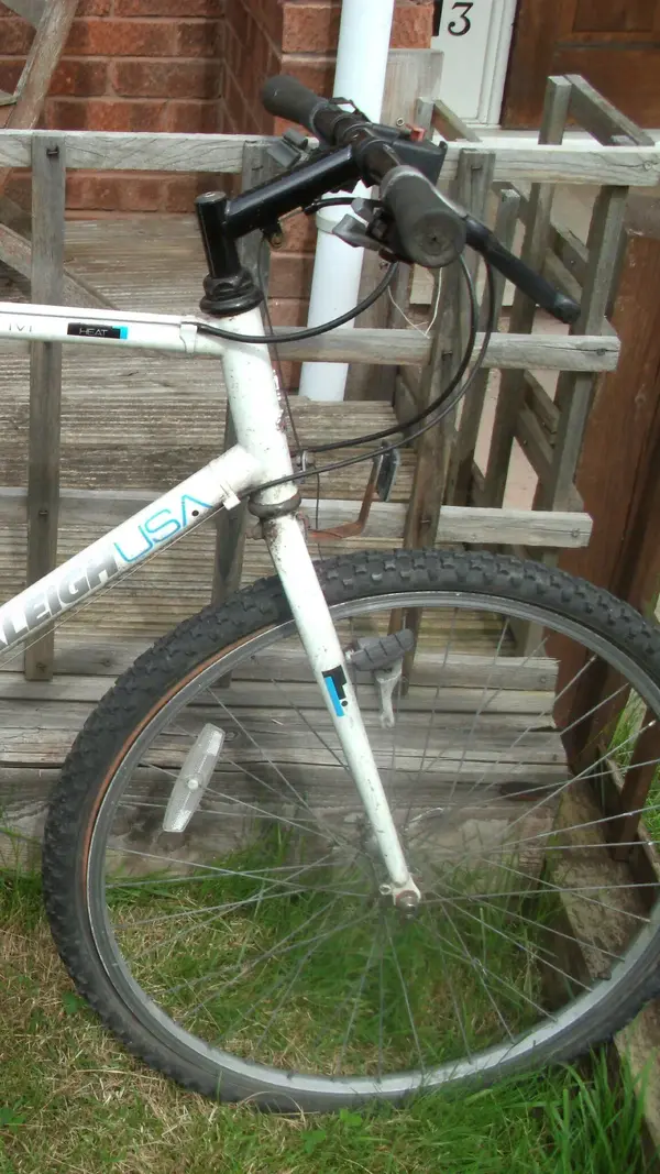

What about Segmented Corrected Rigid Forks from mid90s? It keeps appearing either Tange Struts or Fat Chance... any other brand?
