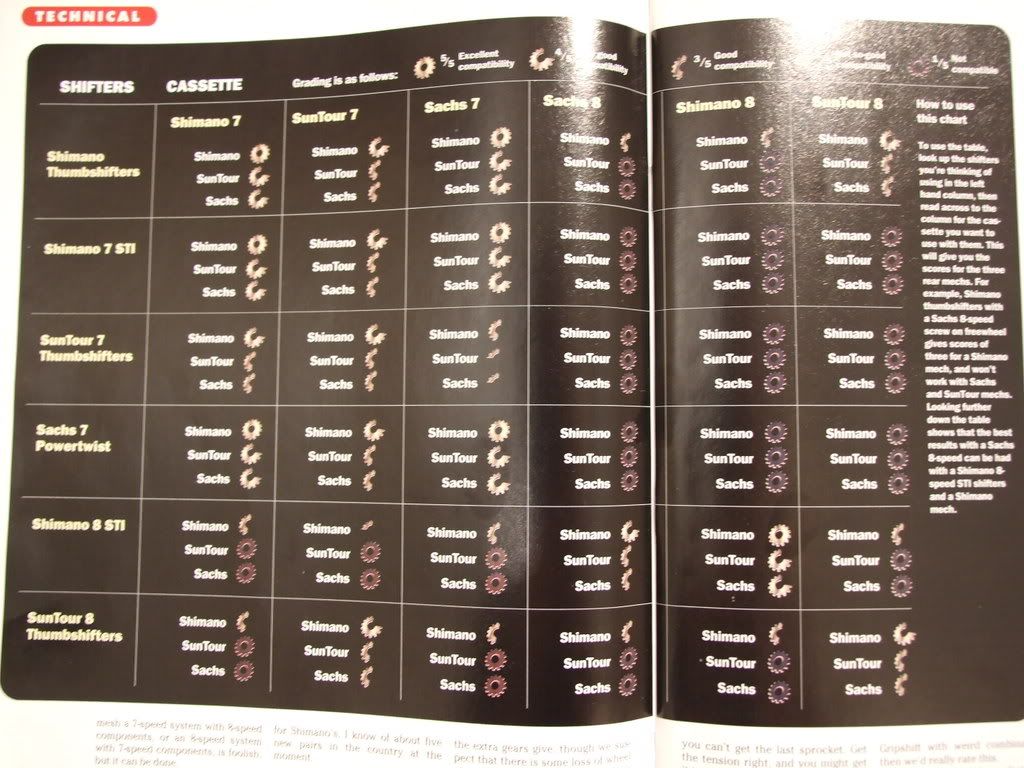

Hmm, Suntour 7's Thumbshifter, Suntour 7's Cassette, only 3/5 compatibility with a Suntour rear mech, but 4/5 with Shimano.
