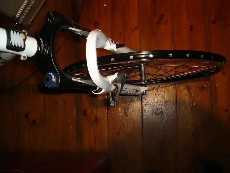

Fitted the Dart forks yesterday and starting on a few other bits today. I bought a short stem, found some straight bars stored, spare mechs and so on.
I am going to probably steal some tyres from my Dynatech for a few days, or perhaps just drop the wheels over whilst I get some sorted.

Pic of Forks:
