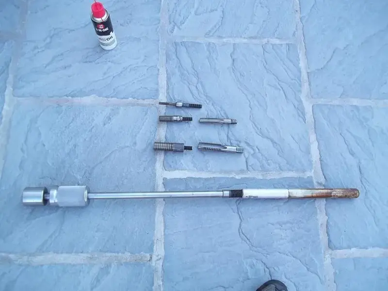

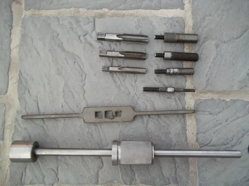

Below in the first photo is the slide hammer kit that i've made, specifically for pulling seatposts. There's the slide hammer itself, three old Whitworth taps and matching inserts 3/4", 7/8" and 1", a laser cut tap wrench to fit all three taps and finally a 6mm insert for pulling out stuck quill wedges.

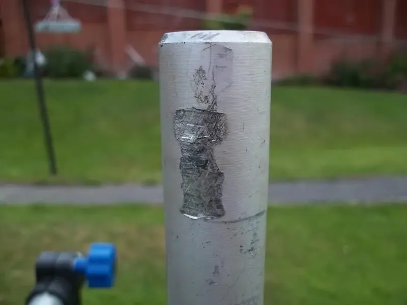

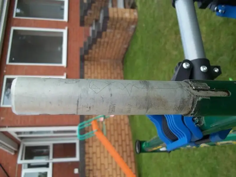

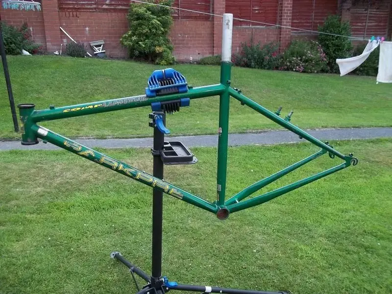

There's also a couple of photos of the frame with stuck seatpost and one of the vice marks from the last attempt at removal.

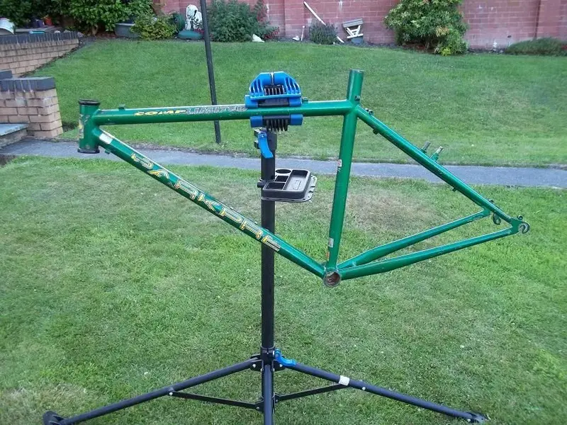

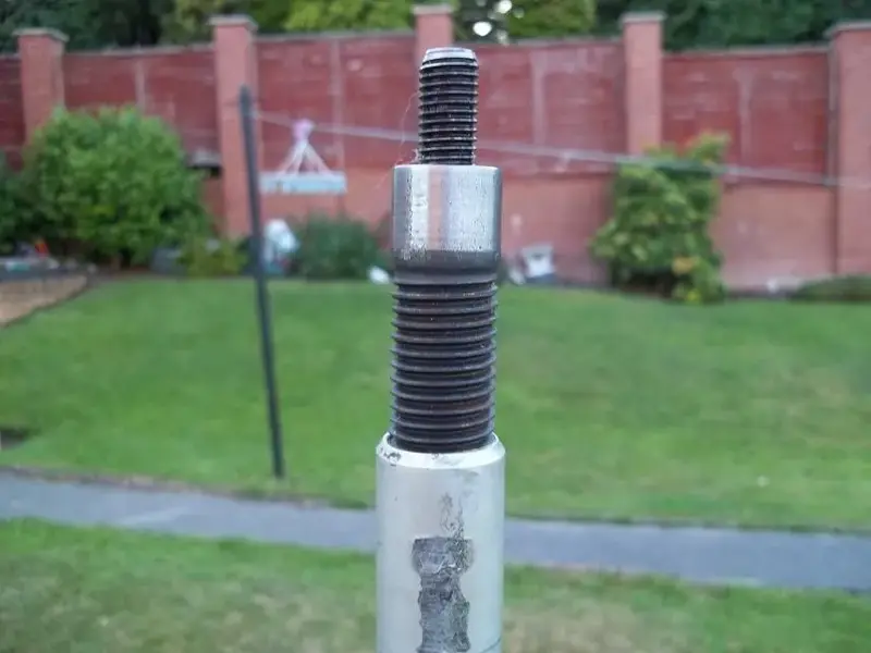

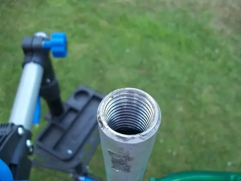

First job then was to tap out the top of the seatpost for an insert. Andy, the previous owner, had had the top come off when he was trying to remove it in the vice so that was the first bit already done. I didn't bother to measure the hole, the 3/4" tap just fitted in so it was pretty obvious that the 7/8" tap would leave a good strong thread.
The first two photos show how far I got the tap down, that was about as far as I could get it to go but easily enough. Don't let the frame in the workstand photos fool you, this was done standing on the lawn with the frame between my legs and a fair bit of swearing. If you have any tapping experience you'll probably realise that tapping a 7/8" thread with a crappy old tap is pretty hard work, even in alloy.

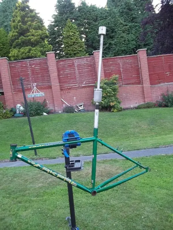

Gave the thread a blow out, shook the swarf out of the frame and we were good to go, insert all the way in and then the slide hammer is screwed onto that......

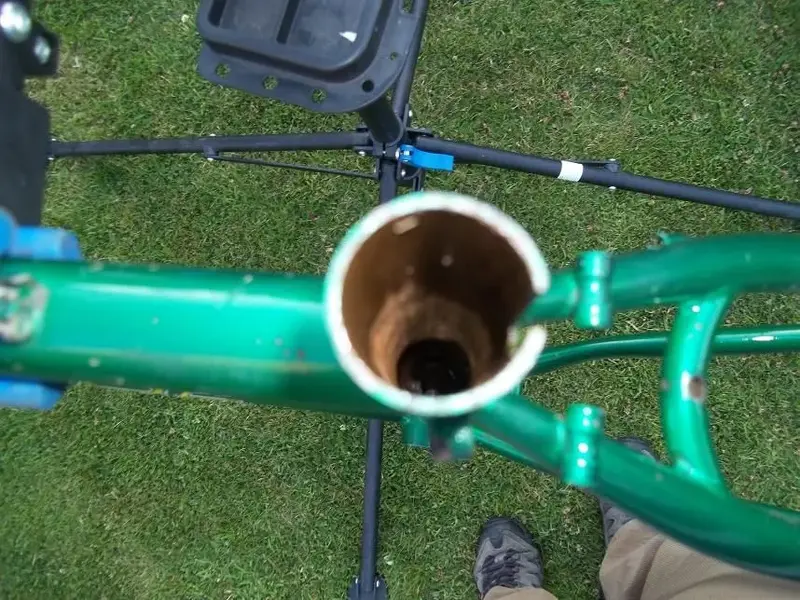

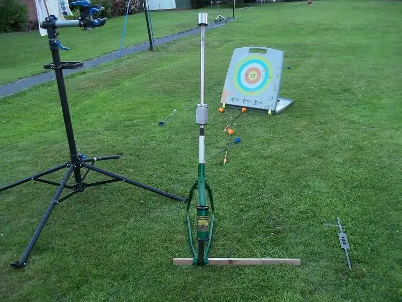

Here we go then, the method, nothing fancy just hit it! As you can see from the first photo I put a piece of wood through the bottom bracket shell and stood the frame up on the lawn. Next I straddled the frame and stood with a foot on the wood on each side. The slide hammer works by simply driving up the knurled part to hit the fixed part at the top. Each time you hit the top you're transfering that energy into a blow upwards like a traditional hammer blow but in reverse. The slightly larger flange at the top of the moving part was to remind me to keep my fingers beneath it, I dread to think what damage a whack off this thing would produce.
The result, well it worked! I'm not going to pretend it was easy or that it came out in three good wallops but slowly and surely it came out. Just like any stuck seatposts, initial efforts show the least results, five hits in and you could just see the dirty insertion mark had risen slightly, ten and it was possibly half an inch but by the twenties it was absolutely flying. I'd estimate it was about 25 blows all in all and it was on the lawn!
You may be able to see in the photos but I'd say this was proper stuck, there was a full 8" in the frame and I'd say that around half of that at the bottom had not seen any penetrating fluid.
This method took around half an hour all together including keep turning the camera on and trying to focus the bloody thing.
