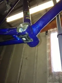

Stripped thread on frame for under BB cable guide

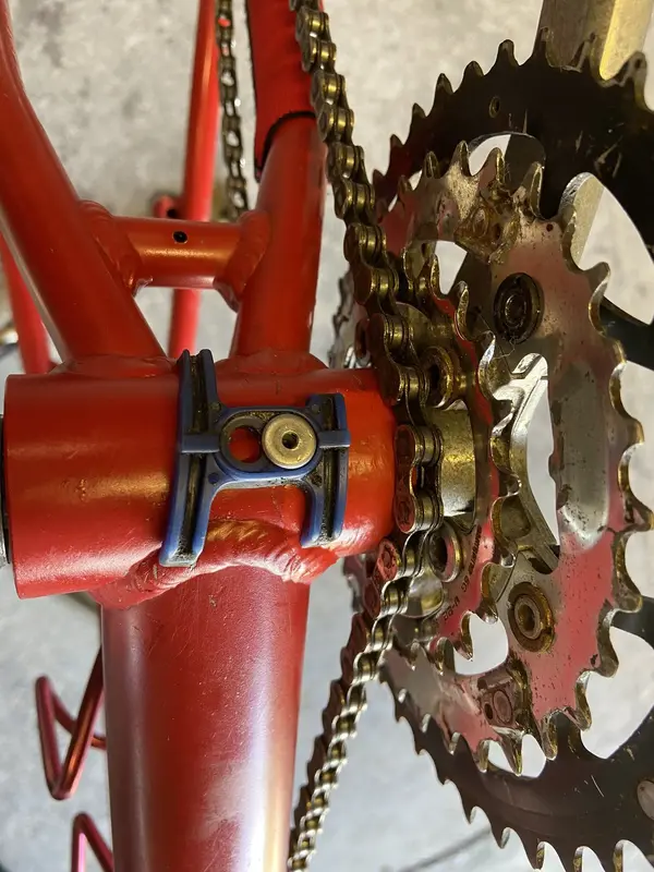

Thanks everyone for your inputs, its very much appreciated and one of the reasons we keep coming back!
Went with the pop rivet - I have plenty to spare, its a bit stronger and more water resistant than any glue or tape down there on the muddy side but still pretty straightforward to remove when needed. I don't think there is any intrusion from the rivet end into the shell space, the sideways expansion of the rivet is holding it in place.
