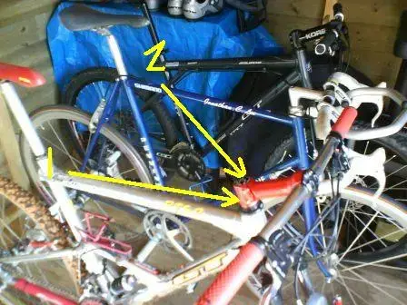

Ok, I am acting a bit blonde here.
To clarify, loosen stem clamp bolts (marked 2) then loosen top cap (marked 1), then tighten clamp bolts up again?
you've got them marked the wrong way round. Loosen stem clamp bolts (marked 1), loosen top cap bolt a fraction (marked 2) then retighten stem clamp bolts.
